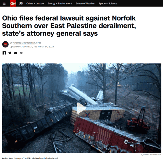

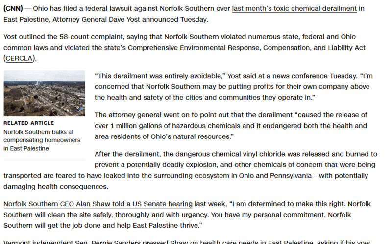

NS seemed to be resisting compensating the victims in the toxic derailment, and now the Ohio state Attorney General has stepped in...
https://www.cnn.com/2023/03/14/us/ohio-norfolk-southern-lawsuit/index.html
