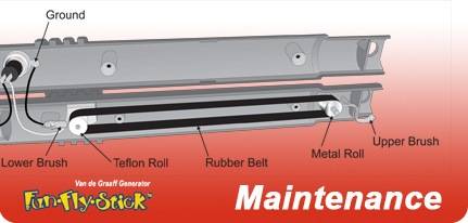

Maintenance diagram of a Fun Fly Stick Van de Graaff generator showing ground, lower brush, Teflon roll, rubber belt, metal roll, upper brush, and the Fun Fly Stick logo.
Referring to http://www.youtube.com/watch?feature=player_embedded&v=oFUD3l3VgeQ", I don't understand the reason for maintenance, does the leaking lubricant on roller create a bridge for short cut to cancel the charges? so it requires maintenance after a period of time, I read some comments, it requires to perform maintenance after playing for a hour.

Lubricant. If there is an oil film beetween plastic roller and rubber belt, there is no triboelectric effect and both materials do not get charged. The triboelectric effect is the source of electric charge that is accumulated on the conductive or semiconductive sphere or tube in Van de Graaff generator. It would be good to use a ball bearing in the toy but it will just increase the manufacturing cost. Unitech Toys put too much oil in one of the manufacturing lot and they have customers' complaints on that. So, they explained how to clean it.

Lubricant. ... Unitech Toys put too much oil in one of the manufacturing lot and they have customers' complaints on that. So, they explained how to clean it.
Does it no lubricant apply to Fun Fly Stick from other distributor at this moment? so this issue would not happen anymore.

Oil Both FFS and Wandarama have some thick oil to lubricate the axle of the upper roller. In most cases it does not make a problem.
I have to admit that Wandarama is slightly more powerful than FFS because it has two plastic rollers - teflon and nylon, FFS has teflon and metal. Wandarama generates some more charge than FFS but the levitation is worse because of more heavy flying toys.
Wandarama strikes sometimes. The lower roller in Wandarama is not grounded properly and the player feels some electric strikes in the finger that presses the button.
When I developed FFS I was not going to provide too much charge. I just wanted to generatete the minimal charge sufficient for levitation.

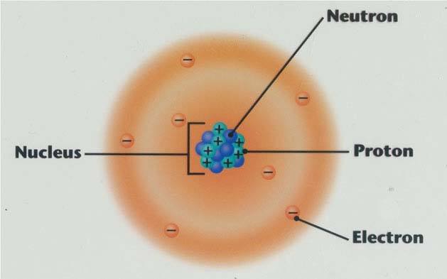

" ... An electron has a mass that is approximately 1/1836 that of the proton."
Is negative charges (electrons) moving faster then positive charges (proton) based on their mass? if it is correct, the speed of discharging the positive charges to the ground is slower then the speed of getting negative charges from the ground, so if I touch the ground by the tube, will the cardboard actually accumulate the negative charges instead of discharging the positive charges to the ground as a result? If this is right, will I get unlimited negative charges from the ground in theory as long as my body is insulated from the ground? so I will accumulate enough volt to lift my hair, please correct me if I am wrong.
Thanks you very much for any suggestions

Sorry for the delayed answer.
You are right that, if the tube is grounded and your body is insulated,your body will get charged negatively.
I do not see here any relation to mass ratio of electron and proton.
You have to consider Van de Graaff as a constant current machine. It just separates electric charges of different polarity with constant speed. You need not go into the proton-electron mass ratio or other atom theory details
