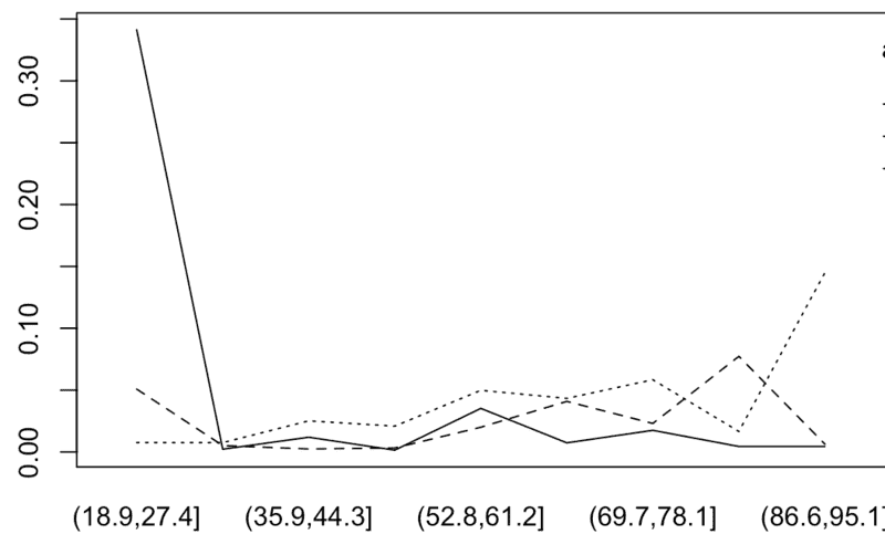

So, I'm doing an interaction model with response vs treatment_type interaction with age+controls(for confounders) with age being continous, say patients ranging from 20 years old to 90 years old.
so I have two models.
y=age+treatment_type . + . age*treatment_type
y=factor(age)+treatment_type . + . factor(age)*treatment_type
Basically what I got was that age is highly significant for the continuous model. For slight deviations in age, there is a huge effect on of treatment.
However, when age is factorized into groups, there is barely any interaction effect. (pvalue not significant)Why? What could be the reason for this. Is the reason why it's so significant for the continuous model is that patients simply differ from each other so much, that it seems like age has an effect, but it really doesn't.
Afterall, it has no effect when looking at groups. But somehow, within the groups, slight deviations give a large effect.

Just 4. But I've factored it again into many. And here's the plot.
It seems that they are maybe canceling.
Looking at your data, it looks like there is only one (solid line treatment, age (18.9, 27.4]) combination that is significantly different from the others. (Are the different lines different treatments?) Is there much data in that combination category or could it be a small-sample outlier?
I recommend that you statistically analyse the one glaring (solid line treatment, age (18.9, 27.4]) combination as one step and then look at the others in a separate statistical analysis.

That doesn't look like it should be non significant. How does the data itself look. Can you see the interaction in the raw data?
When I increase the number of partitions in the factor, it seems that there it follows the same trend(just a bunch of zigzags with the solid one being the most prominant). I think that is why for continuous age, it's highly significant, because even one slight increment in the age could send it in a certain direction.
So split the data into two different sets? It is a small sample. Less than 10% of the data set. Yet, there's only a small amount of people under this treatment option in the first place. So every data point counts. The response is a count of relatively rare events( negative side effect) so most of the response would be zero anyway
From the looks of the data, I think that it would be very misleading to allow the extreme result from one combination of (treatment, age) to influence your conclusions about the other combinations. In fact, the other treatments show, if anything, a slight bit of the opposite trend. If you do not address that combination separately, I don't think your conclusions will have any merit.

Then it doesn't sound like you will have enough data points to justify a large number of degrees of freedom. That is probably driving the lack of significance somewhat.
Also, do you see this interaction when you plot the data itself (not the fit)? I think I have asked this three times now.

I'm not sure what you mean. The pattern that I plotted was based on the data. It wasn't derived from a regression.
