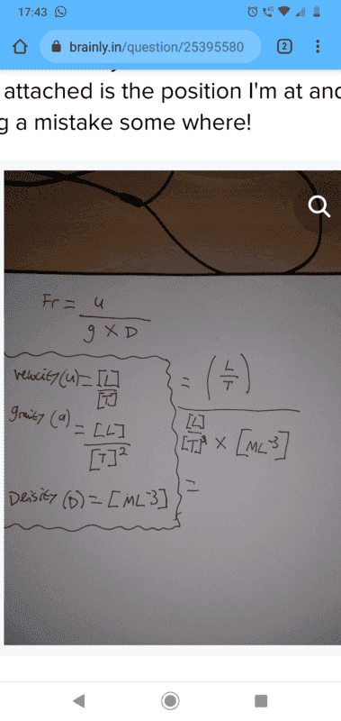

Timburton91
Dimensional analyse the Froude Number (fr) = Velocity (u)/Accerlation due to gravity (g) * Hydraulic depth (D)
fr=u/g*D
So, I have calculated that to dimmensional analyse this equation;
D is hydraulic depth, not density. I think it has different units?
Also, isn't there a square root in this equation?
