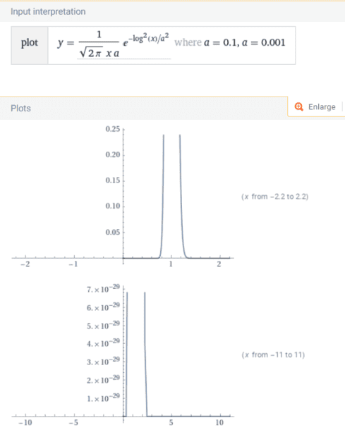

Thanks. I plot https://www.wolframalpha.com/input?...x*a)e^(-+log(x)^2/a^2)+for+a=0.1+and+a=0.001+
This does not look to me like a delta function. δ(-x) is zero for positive x. Your function isn't even defined.

defined in x>0. Plot in #4 shows it. BTW how do you design specific gravity x plays a role in the formula ?
