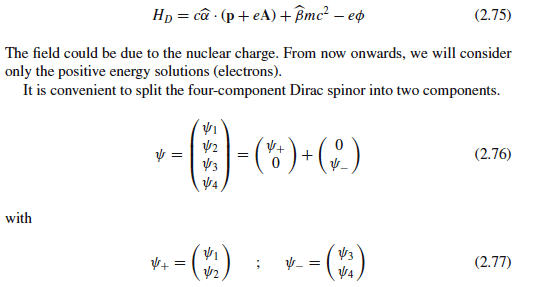

I'm studying about dirac equation and it's solution.
When we starts with the equation (2.75), I can understand that it is possible to set 2 kinds of spinor.

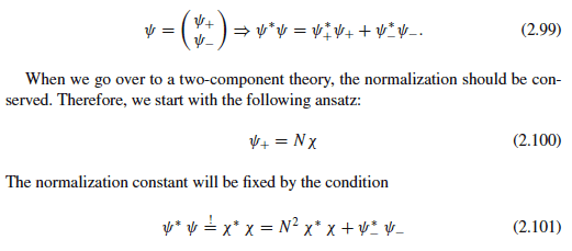

But my question is...
1. After the assumption (2.100), how can we set the equation like (2.101)

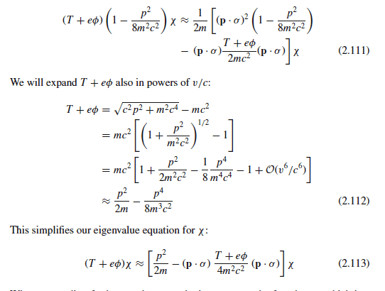

2. I can't get (2.113) from (2.111) using (2.112)... Approximation and operator made me so crazy!
Please help me...
First step: what is ##(\vec{p} \cdot \sigma) (\vec{p} \cdot \vec{\sigma}) ## equal to?
Equal to ##\boldsymbol{p}^2## !
Right!
Now, the key point is that they work up to order ##p^4##, i.e. they drop all terms of higher order.
So notice that the following term on the left of (2.111) is
$$ (T+e \phi) (-p^2/(8m^2c^2)= -p^4/(16m^3c^2) ~\text{plus terms of order } p^4 \text{ and higher}.$$
This term cancels exactly the term ##- (\vec{p} \cdot \vec{\sigma})^2\, p^2/(16m^3c^2) ## that appears on the right side. This leaves Eq, (2.113), which is valid up to order ##p^4##.
