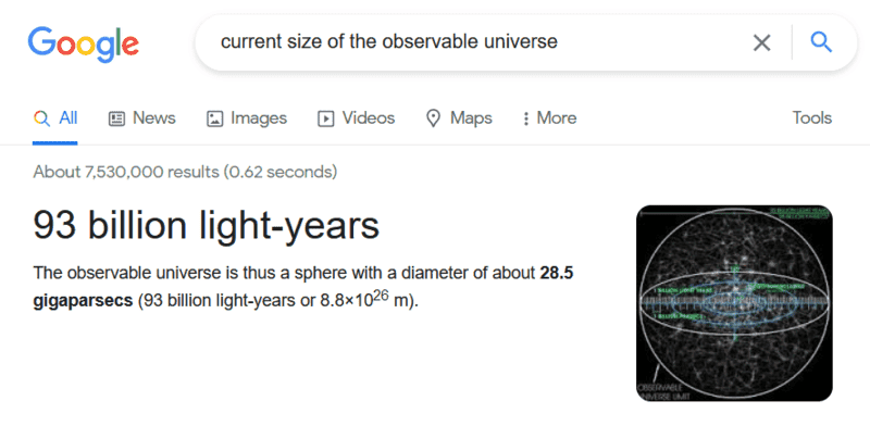

I have a question for Janus though. If the "observed distance for the furthest objects is now somewhere around 12-13 billion light years and it took the light that long to get to us, space also has that long to expand...
So observed distance plus looong expansion... The the universe should be much bigger than 13 billion light years.. but that's what I hear.
Uh ... Google is your friend
Re: the distances reported - the sources you may find out there are not always terribly clear on what distance they mean. Sometimes they mean the 'light travel time' distance Janus mentioned, sometimes the distance the objects are at now (as the figure for the size of the observable universe in the post above).
Oddly enough, nobody ever seems to report the distance at emission.
