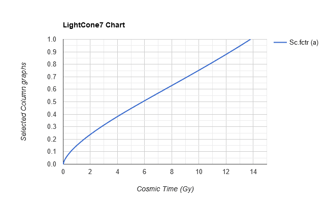

Looking at the graph of ##a## vs ##t##, what you said is actually roughly true for a large chunk of cosmic time!
It is not true for the first 3 Giga years or so due to dominant radiation energy. Also not for the last 4 Gy due to the accelerated expansion, but still close.
It requires a bit of juggling of settings in the LightCone7 calculator to produce this particular chart.
But I was talking about proper distance between comoving objects vs. ##a##. Do you say scaling of ##a## with proper distance is epoch dependent?
In terms of the OP question, as I understood it, I think yes. Light does not travel the proper distance in expanding space, but simply ##c\Delta t##. By the time it arrives at the receiver, the proper distance between emitter and receiver is larger than the distance light actually traveled.
