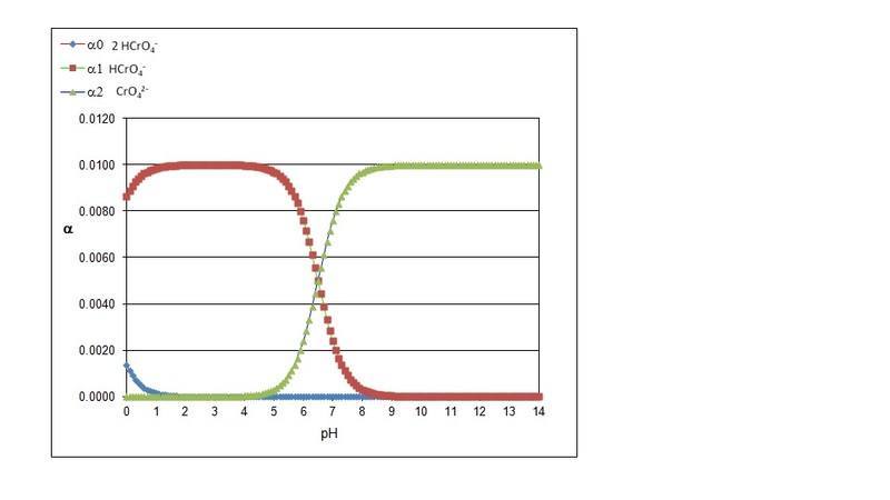

Hi, this is some Geochemistry homework. We were not really given much information on how to approach this problem. I treated it as a diprotic acid H2CrO4, and made an alpha plot using the equations given using the constants K only for the fully protonated and deprotonated species. I'm not sure how to approach this problem with four constants and plot the distributions of four species at different concentrations.
Any suggestions?
Make a distribution diagram for the various Cr(VI) species as a function of pH at CrT=1, 10-2 and 10-4M. Neglect activity corrections.
Equilibria: CrO42-+H+=HCrO4-; logK1=6.5
HCrO4-+H+=H2CrO4; logK2=-0.8
2 HCrO4-=Cr2O72-+H2O logK1a=1.52
Cr2O72-+ H+=H Cr2O7- logK2a=0.07
[Cr]T=[CrO42-]+[HCrO4-]+2[Cr2O72-]+2[HCr2O7-]

See the attached jpeg for my alpha plot.

Using just formulas you listed you can prepare a plot for dissociation, but not for dimerization. To be honest - I have no idea how to solve this particular problem in a simplified way. You can try to read about general approach to chemical equilibrium calculation, but it leads to sets of nonlinear equations that are difficult to solve manually - the only viable approach is numerical.
Thanks Borek. I think I'll work on the numerical approach, maybe Newton-Raphson. This class, I think, was a mistake. It's a combined grad/undergrad class, and I've spent so much time reading Analytical Chem and Thermodynamics (classes I have NOT taken) that I've neglected my physics class and will have withdraw.

With the original assignment, this is exactly what I did. The plot, of course, didn't account all of the species though, especially at the very low pH.

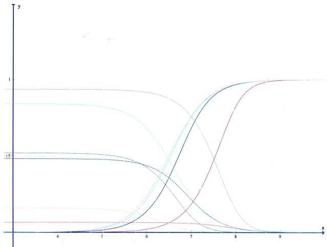

OK I found this problem of interest and I have done it for the simplified system, the figs would be very accurate above pH 3.5. It is retarded because of confusion and mistakes in the numerical calculation/plotting plus also I was being thrown out of the site every time I tried to view the post.
This is simplified to the system ½H2Cr2O72-[itex]\leftrightarrow[/itex] HCrO4-[itex]\leftrightarrow[/itex] CrO42- + H+.
red is 1M dark blue is 10-2M azure is 10-4M
However I could not upload my computation directly and had to scan a printout – for some reason a red curve (uppermost on left) looks blue!
I suggest you will find it easiest to go by stages. First just formulate and solve for [X], or better for [X]/[XT] in a simple monomer dimer equilibrium ½X2 [itex]\leftrightarrow[/itex] X. This does involve solving a simple quadratic. On reflection and remembering previous comments this is nothing special – for any general bimolecular process like that, or A + B [itex]\leftrightarrow[/itex] C even A + B [itex]\leftrightarrow[/itex] C + D to calculate the equilibrium position if all you are given is the eq. constant and total amounts e.g. of starting material you always have to solve a quadratic I think. (It’s true pH and buffer problems that are a major part of this forum are bimolecular H+ + A- [itex]\leftrightarrow[/itex] HA and you manage mostly without quadratics – that is because you are given extra information about the equilibrium point in those problems – either [H+] or [A-] by the concentration of counter-ion and electroneutrality or added alkali etc.)
Then when this is clear you can add an extra equilibrium of a deprotonation of the X and you have the system above. You will see you can easily do the whole system and these ionisations are kind of pendants to the polymerisation. Reversing my previous opinion something like your a’s can be helpful after all.
Now I understand you meant the pK’s of bichromate are 1.52 and 0.07; they do not come into my simplified model where it is always 2-. You do not give a constant for dimerisation KD. I have used the value 224 M-1, you use whatever you are given, but I find a difficulty.
What does molarity of a dimer or polymer mean? - I do not actually know whether there is a convention about this. I prefer to use the ‘atomic molarity’ I,e, for instance the molarity of chromium atoms in the two forms. That allows me always to use a simple conservation equation in all cases, like
[A2] + [A] = AT
without thinking about multiples all the time. But then I have to convert a given molecular KD multiplying it by two. I took the constant from here http://en.wikipedia.org/wiki/Predominance_diagram because at least the constant is defined there which it wasn’t in two other sources I found. Also there is a motivation for preferring to express things as dissociation constants, in this case about 4.4X10-2 M as this gives the idea of the concentrations over which things are in balance and the greatest changes happen.

OK I will nearly complete this with a few points I think worth noting.
1. Students should generally be able to reason, even beforehand, that qualitatively the results are those to be expected.
2. One should have an eye for thermodynamic reciprocity. E.g. the fact that the pH profile is different at different pH’s means that varying the concentration, e.g diluting a 1M solution around pH 7 with water would change the pH, in contrast to ordinary buffer systems where (ideally, without ionic strength effects) it would not vary.
3. At low molarity the system simplifies to only the HCrO4-[itex]\leftrightarrow[/itex] CrO42- + H+ system. The curve is then of the form of a simple titration curve. The black curve (which I did not previously mention) in the fig of the last post is such a curve for pK 6.5 chromate assuming no dimerisation and has that form - and is quite close to the curve at high dilution (10-4M). Though it is not very obvious the curves at higher concentration do not have the same shape as a titration curve and are not parallel to it but steeper. This can be better seen by checking, e.g. with a ruler, the horizontal distance between the curves which decreases as you go upwards. This is an example of co-operativity, the deprotonation gets easier as more is deprotonated.
4. The calculation can be easily completed for the low pH’s with their extra protonations. The low pKs are noted to be ‘not well known’ with widely varying estimates. I never had to deal with things at pH’s as low as 1 or 0 and as far as I remember anything happening there was considered with scepticism. However to able to do that sort of calculation and not be afraid of it is the point of this exercise. For that matter there seem to be varying estimates even of the mid-range pK given as 6.5, perhaps a matter of varying conditions. This should stimulate a reflection – how would you actually determine the various constants experimentally?
