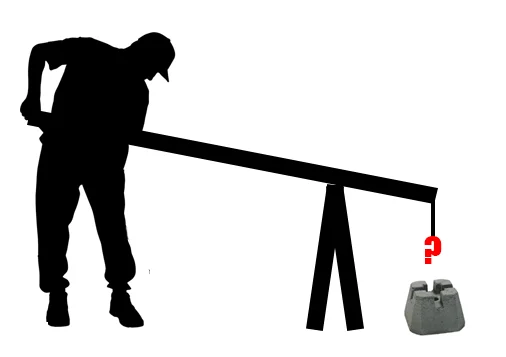

I want to manipulate concrete footings while saving my back. The trick is how to grab them and release them.

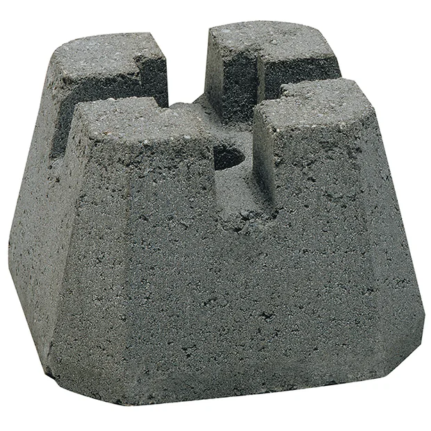

Building a pool deck on a frame over concrete footings:
~ 12"x12"x8" 50lb.
I am ruining my back trying to lift, place and fine-tune the locations of dozens of these footings.
My plan is to use a 2x4 and a sawhorse as a lever and fulcrum to move them arouund without injuring myself.
The part I can't figure out is how to grab the footings. I could cobble together a giant claw to pick it up by its edges, but I think that's overkill. (although if you think of something I'm all ears.)
The footings have a hole down the centre that's about 1 1/2" in diameter. I could drop a tube down there on a rope. I'm just looking for some way of securing the grabber on the inside or bottom of the hole.
This is a schematic:
The grabber doesn't have to be elaborate. Super simple is best. It could be just a big nail that I can twist into place or something. A clamp, a slipknot; an inflated balloon, what-have-you.
I just haven't figured out how.
And this does not have to be how I do it at all. Any suggestions about moving these blocks around in a back-saving way are welcome.

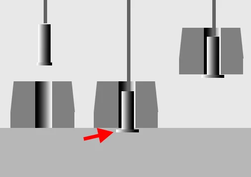

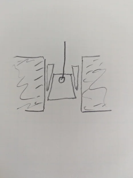

There is this kind of self-locking thing...
Yeah. That's the kind of thing I'm thinking of.
Or some sort of wedgy thing you can cobble together from wood scraps. Expect it to slip at some point, just to be safe.
Oh I see what you're illustrating.
Drop a dowel in the hole, just a little smaller than the hole's diameter.
Wedge in a shim or two.
Yeah, that might work pretty well.
Lnewqban said:
Yes, I figured I could do it by welding some bars together; I'm trying for a solution that's a little less overhead just to build the device. I can cut and grind and bolt, but i can't weld - not conveniently.
These ideas though, are simpler than I imagined, so may be worth a gander.

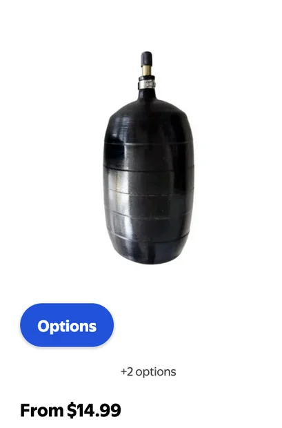

DaveC426913 said:
Yeah, balloon is a great idea in theory, but inflating and deflating it is gonna be troublesome.
There are things to put into pipes that can be inflated with water pressure from a hose.
Like this:
They are made on tough rubber.

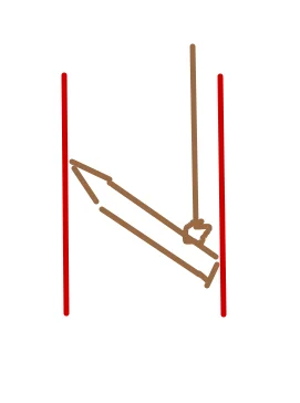

https://unistrut.biz/content/Resources/Literature/Unistrut-General-Engineering-Catalog.pdf

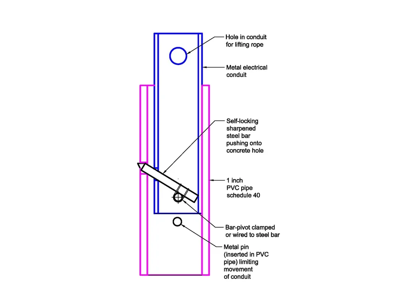

The simple system shown in post #2 could be done with a perforated 1-inch PVC pipe (in place of the red lines) and an internal metal conduit of smaller diameter containing one or several articulated pins.
The internal conduit is pulled by your lever, locking the pin(s) against the concrete.
The internal conduit is pushed down while the PVC pipe is pulled up to release the lock.

DaveC426913 said:
Thanks I don't quite follow this last bit.

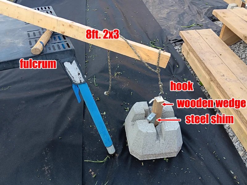

I went with the stake-and-shim.
The shim is steel, with a 90 degree bend, so I can pound it in with the fulcrum hammer.
It does slip, if I don't pound in the shim enough, but it does the trick.
(My goal is different from most workplace goals. My goal is not time-efficiency - it's not over-exerting myself. In fact, I have no problem working slowly, because it means I intersperse the heavy labour bits with fiddLing bits.)

@DaveC426913 In that picture, is that steel thing (blue) what you can buy to do the job? A hole, drilled on the end of the handle could allow lifting that with a lever.
That's just a bog standard work table. It's the right height to act as a fulcrum, and is plenty broad enough to be stable while I twist and turn the footing. In retrospect, something more tripod-like might have been easir to maneuver ubut this was there when I needed it.
