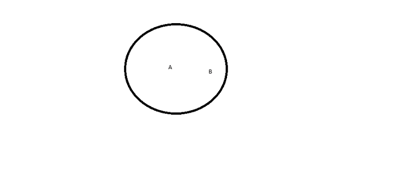

I don't mean the center of the spherical body. In the diagram below, should the red shift be more at point A as compared to point B because A will be moving directly away from us as the object contracts while B will move rather diagonally.
gotcha, your talking from the surface on both points, then yes. A will move away from us faster than B

lets try this your observer C on earth, take the image you posted on post number 9. with a and b. Now that circle you posted is 3D, a planet. So as B moves towards point A on that 3D image. the distance between B and C decreases, hence its moving towards you=blueshift.
In Drakkiths example observer A is the center of a circle, B is a point on the surface. As the surface contracts B moves towards A =blueshift
