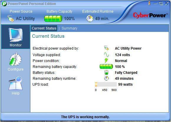

Except when you are connected to a UPS. There are UPS designs that are installed internally in a spare drive bay.
So there are some rare cases where the desktop has a battery to run the whole system. The run time is generally just long enough to save your work and shut down. It is not for general use.
BoB
I think it is wise to have a UPS for a desktop PC. I have one that will power the PC, monitor, and a small LED lamp for a short time so I can close files I am working on and shut it down if the power goes out. (My power does out a LOT at unexpected times.)
