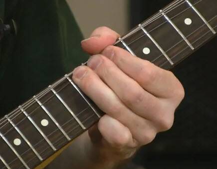

This same process of increasing tension on the string to create a "pitch bend" is intentionally performed by guitarists when they perform a note bend, where the length still remains constant (unchanging fret position) but by bending the string, tension is increased and note pitch goes up.
I think it is the same phenomenon in both cases.
(^ String length slightly increases during a pitch bend which would lower pitch overall, but mostly tension of the string goes up like crazy during a bend, so the note pitch goes up.)
I think this is the same thing that is happening also with an aggressive pick - just more momentary with the pick.

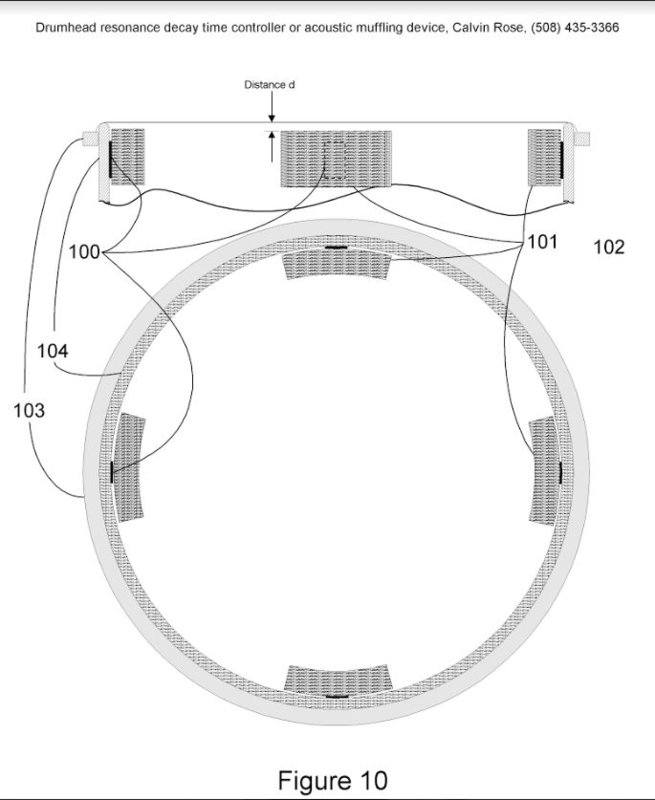

Hi All, I just noticed this forum and I wrote the 1978 paper on pitch bend in drum heads referenced in my friend Thomas Rossing's book. If you want to try something really cool and useful, put some open cell foam (preferably 1" thick) on the inside of your tom-tom, bass drum, or snare rims 1/8" away from the drum head. It will kill the overtones without touching the drum head. In the attached photo, the distance "d" should be about 1/8 inch. I was going to patent this idea, but decided to publish it instead so people would hopefully use it. The benefit is it dampens out the overtones without killing the stick or pedal strike on the head.
