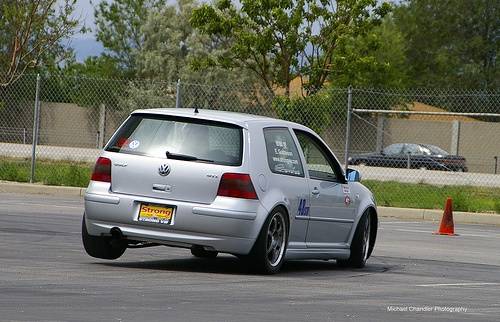

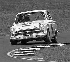

Or one wheel will lift off the ground:
roll angle is not same on both end. This is because different forces are acting on each axel. Look at photos posted above by Jack..also you can not isolate reaction to weight transfer to spring rate only. ARB is a spring and you also have aero down force impacting on the event if speed is high enough. To discount the action of the tire is to miss the entire point of dealing with weight transfer. It is all about tires, Tires, TIRES.
Lifting a wheel is not what I am looking at. What has happened there is simply that one axle has transferred 100% of it's load and as a result the inside has lifted. I am concerned with the roll angle prior to wheel lift.
Mike, my calculatios for roll angles end up giving the same wheel deflection front and rear, no matter what combination of springs, roll bars, ride heights, motion ratios or track widths are used. If the wheel displacement is the same, the roll angle is the same. This just seems correct to me.
If the front and rear are to roll different angles, the difference must be taken in chassis flex. Now, assuming some 10,000N/m torsional rigidity, one would have to assume that given the loads in question, the degree of flex in chassis is going to be small, to the point of not being worth considering.
Wheel lift is exactly a different roll angle at front and rear. Look closely at the picture, especially the one in black & white: With respect to the rear axle, the body has a certain roll angle, but with respect to the front axle, the body has a lesser roll angle, hence the inside wheel is off the ground.
Even if the wheel is not off the ground, the tire is also a spring and will «elongate» accordingly, until it can't anymore. That is why your body don't need to flex to absorb the different roll angles, the tires are the one «flexing».
