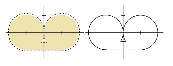

Im not sure if I completely understand what you're asking. But consider the set S = [(-1,1)X(-1,-1/2)]UB[(-1,0),1]UB[(-1,0),1]:
Two side-by-side diagrams of a shape made of two overlapping circular lobes that meet at the origin, with a flat bottom edge; the left version is filled in tan with a dashed outline, the right version is an unfilled solid outline, both with x and y axes and a small triangle marking the origin.
Where B[(x,y),r] is the open ball at (x,y) with radius r. It's open, and it's simply connected since the origin is not in the set. But the origin is a self-intersection point of the boundary, and the compliment of the boundary is the union of three "sides".
We could extend the boundary out to infinity by considering A = SU[(1,infty)X(-1,-1/2)]
