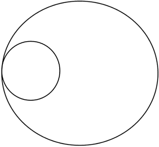

So let me propose an explanatory thought experiment which, I hope, will clarify the issue for you. Imagine two clocks traveling on circular tracks at the same tangential velocity (one circle inside the other but touching at a point.)
Let the clocks start clockwise around these circles with the same speed as measured by you who are free floating and see the circles as stationary.
The inner circling clock will experience a stronger acceleration than the outer one but both are traveling at the same speed in your frame and according to each other when they happen to come together at the tangent point. Let's also make the the big circle's circumference a rational multiple of smaller's so that after the inner clock makes n turns and the outer clock makes m turns they will both be at the tangent point at the same time (though each may measure that time as a different value). The question then is what will the two clocks read at this point? Different values or the same value?
I think they will agree on times (and be slower than your clock if you also are standing at the tangent point.) But I need to sit down with pencil and paper and work out the details. (It's been awhile since I played with this.) I will do this and post my figures. In the mean time, does this scenario address your question?

I should have recalled but yes they will agree. In this scenario the differential time rates will only depend on their speeds relative to the stationary observer and since they travel at the same speed for the same amount of time they will have the same proper times.

You have to be a bit careful with your definitions here. In an inertial reference frame, the speed of the clock as measured in that frame is the only thing that you need to determine its tick rate. The only way acceleration enters into it is that it can affect speed.

Hi Ibix:
Your statement above raises the following questions with respect to the two circle example in post #4.
When moving at a uniform speed in a circle, is the rotating reference frame inertial?
When moving at a uniform speed in a circle, is the non-rotating reference frame inertial?
Regards,
Buzz
When you are at rest in a frame, do you weigh anything? If yes, it is not an inertial frame. Whether or not the frame you are working in is inertial has no bearing on whether or not any other frame is inertial.
Someone at rest on a train circling either of those tracks will be plastered against the outside wall of the train.

Hi Ibix:
Sorry to be so dense.
From what you just said, neither of the travelers on the two trains on circular tracks are in an inertial frame. Therefore based only on your earlier quote, it is not necessarily true that the only thing those travelers need to do determine the speed of their respective clocks is to count tick rates.
So, do they or do they not have to do anything more than count tick rates?

Their own clock ticks at one second per second, as always. To determine the rate of the other guy's clock they can count ticks, yes. You can always count ticks of someone's clock (at least in SR...).
The complication in every inertial frame except the one where the circles are at rest is that the speed of the circling trains is not constant, so calculating the elapsed time for the circling observers isn't necessarily trivial. In non-inertial frames the relationship between velocity and tick rate also depends (in general) on the location and time that you're thinking about, which is yet more complexity.
