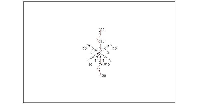

Special relativity shows that any accelerated observer
sees an event horizon. In fact, if an observer is accelerated
by a, the horizon is at distance l=c^2/a in the direction
opposite to a.
If an observer is on a carousel or merry-go-round,
he is accelerated inwards. Does he then see a horizon
on the outside?
If so, does a horizon also appear for an observer in orbit,
thus when circling the Earth or the sun?
Hz
No.
For an observer with constant 4-acceleration, there is a region of spacetime from which no signal reaches the accelerated observer. The boundary of this region is the horizon.
For the observer on a carousel, there is no such region of spacetime, and thus no horizon (boundary). A spacetime diagram that has two space dimensions and one time dimension shows this clearly.

Suppose that the centre of the carousel is in an inertial reference frame, that the plane of the carousel is the x-y plane, and that a person on the edge of the carousel moves with constant speed 1/2 (c=1).
Then, the coordinates of the person on the edge are [itex]x = \cos \left( t/2 \right)[/itex] and [itex]y = \sin \left( t/2 \right)[/itex]. Plotting this worldline on a t-x-y spacetime diagram gives a helix about the t-axis (worldline of the centre).
Now pick an arbitrary event in spacetime. The attached spacetime diagram shows that there is a lightlike path from the event to the worldline of the person on the edge of the carousel.
