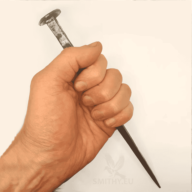

DaveE said:
Funnily? That's what I do to all of my old HDDs. Hit them a couple times with an axe. It's easy and then I don't even have to consider whether I care about what might be on it. Only the FBI or NSA could get data off of those, if they're lucky, and they would really, really, have to care about it to try.
I once put one of these through my hard drive before disposing of it.
It sends a message that says 'don't even bother'.
