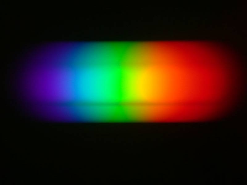

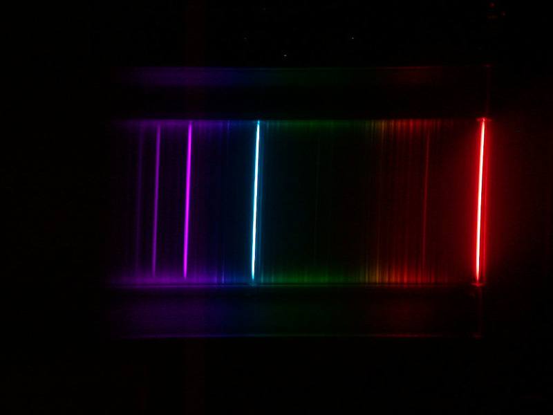

When I used to conduct undergrad labs, one of the things I like to do when students were using a spectrometer to look at the emission lines from gasses, is to also have them look at the spectrum from an ordinary, incandescent light bulb. Here's an example.
This is a typical spectrum from a hydrogen discharge tube showing the Balmer lines:
Spectrum from a gas discharge tube showing discrete bright emission lines at separate wavelengths, with violet, blue, cyan, green and red lines on a dark background.
This is an example of atomic transition, where you see discrete spectral lines. Now, compare this to the spectrum from an incandescent light bulb:
Continuous spectrum from an incandescent source, a smooth band of colours from violet through blue, green, yellow and orange to red with no discrete lines, on a black background.
One can immediately see a clear difference between the two. There is more of a "continuous" blend of colors or spectrum, meaning that the light emission here covers many, many wavelengths that are practically continuous.
{Credit: http://www1.assumption.edu/users/bniece/spectra/lightsources.html"
This is because the emission mechanism for these two light sources are very difference. Light just doesn't HAVE to be emitted via atomic transition. It can also be emitted via vibration, agitation, etc. of charged particles. That is how we generate light at synchrotron light sources, for example.
So this misleading idea needs to be corrected.
