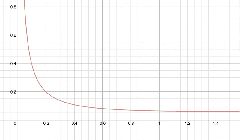

I'm a slow typer. I promised I'd get you some numbers but it might take a few minutes. The present rate of distance growth is 1/144 % per million years and the longterm residual rate it is tending towards is 1/173%. That is what you get from Einstein's Lambda constant. But I'd like to show a curve that plots the history of that growth rate say from year 1 million up to the present, and on into the future some so you can see it leveling out.
...it took me a while...
what I had in mind was something like this (I have to explain the time scale. it is in units of 17.3 billion years, so x=1 is 17.3 By and the present, about year 13.8 billion is around x = 0.8
using that time scale makes the formula simpler. I'll get a conversion table for the time scale later, for now just remember that the present is 0.8.
This shows the history of the growth rate. It is leveling out at about 6% per billion years. You can see it leveling out at around 0.06, which is 6%
More precisely 1/17.3 = 0.0578, but .06 is close enough so let's call it 6% per By growth.
The current rate is close to 0.07, about 7% per billion years.
If you look closely at the graph where x = 0.8 you'll see it says 0.07.

It turns out that our universe's distance growth rate is not constant but declines along a kind of nice sloping curve.
Lambda is a constant that helps to define that curve.
But first, tell me if you have had any school work with trig functions (like tangent(x) and cotangent(x), or tan(x) and cot(x), for short). And if you have met their relatives tanh(x) and coth(x).
If you haven't then I need to think of a different way of explaining that first curve. It is y=coth(x) and it turns out the universe's growth rate has declined following that curve.
Whats the y-axis on this graph you are trying to tell me change in time and change in smthing but I didnt understand the other y-axis excuse me but what's means present rate of distance growth 1/144% per million years and what's the grow rate why there's % (these question can be simple or stupid but I don't have enough english and cosmolgy knowladge to learn understand it)
Thanks for help
The x-axis is ordinary time divided by 17.3 billion years.
That makes a convenient small number.
For example, the present time is usually said to be around 13.8 billion years.
If you divide that by 17.3 billion years you get 0.8.
So suppose you print the graph out on a piece of paper. You can put a dot on the x-axis at 0.8. That is the present day.
The y-axis is fractional growth per billion years.
So you can read from the graph that the present rate of distance growth is 0.07 per billion years. that is 7% per billion years.
That is the present growth rate that astronomers measure
and their observations show that it is heading down towards 6%. Or just slightly less than 6%

Well 1/144 = 0.007
So imagine that in a million years the distance grows by .007% of itself.
0.007% is the same as 0.00007. In a million years the distance grows by 0.00007 of itself.
In cosmology, distances grow very slowly
Now the growth rate does not always stay the same! It declines according to that curve I plotted.
But if it did stay the same for a billion years, the distance would grow by 0.07 of itself. (I took away three zeros because we stepped up from million years to billion years, so larger fraction.)
Does this make sense to you? The current expansion rate is 0.07 per billion years (but that is just the rate per unit time.)

But you left out the decimal point. It is not "1/144 per billion years". the present growth rate is 1/14.4 per billion years. that is roughly 0.07
The longterm rate (determined by the cosmological constant Lambda) is not "1/173 per billion years", it is 1/17.3 per billion years.
Very roughly that is 0.06
So you can see that the curve is 0.07 at present and tending towards 0.06
I should make you a table for converting time (in usual scale of billions of years) to time on the x-axis scale.
To convert you have to divide by 17.3.
Imagine that we have a new unit of time called the UNIVERSE DAY, it is 17.3 billion years long. Or we will name it after you and call it a QDAY.
Now the present age of the universe is 0.8 Qdays.
Can you get used to thinking of time measured in Qdays? That is what the x-axis of that plot measures.

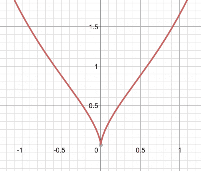

Now maybe we are ready to look at the expansion history. It is the history of any large cosmic distance. Growth is proportional to size, so every history looks the same. The unit of distance is arbitrary, you can choose what you want it to be. Suppose you choose it to be a billion light years. Then this graph plots the size of a distance between two galaxies which was one billion light years at time x=0.6.
That is 0.6 Qdays, which corresponds roughly to about year 10 billion.
I think you are getting the idea, Q. This distance was 0.3 billion LY back at time 0.1 Qday.
then it grew and grew. By 0.6 Qday it was already 1 billion LY.
Then it continued growing and by the present day of 0.8 Qday it is already 1.3 billion LY.

Now we have a galaxie which distance is 1 billion light year away.than x-axis shows us the change in 1/Qday and y is distance from galaxy.
So If I get it when x=0.23 than distance from galaxy is 0.5 light years. and that day universe is 0.23xQday=4 billion years after universe created
Quarlep said:
Now we have a galaxie which distance is 1 billion light year away...
So If I get it when x=0.23 than distance from galaxy is 0.5 light [billion] years. and that day universe is 0.23xQday=4 billion years after universe created
Good.
We are talking about a galaxy which is 1 billion LY from here at time 0.6 Qday. And we are looking at what distance it is at other times.
You point out that at 0.23 Qday it is just HALF as far---it is only 0.5 billion LY.
and truly on that day the age of the universe is 4 billion years. Your number is correct.
