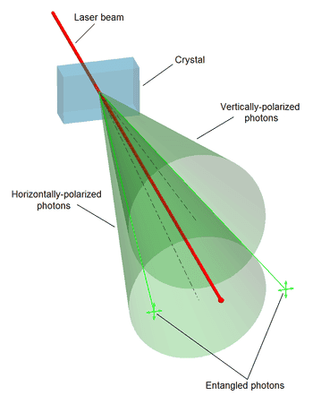

But in SPDC, it is the horizontal and vertical photons that become entangled where the emission cones intersect. They do not have indistinguishable polarization from their creation, rather they are emitted into horizontally polarized and vertically polarized cones. Where these cones intersect, the polarization is indistinguishable.
So how it is you say photons of different polarizations cannot interfere when the below photo shows they do?
" Importantly, the trajectories of the photon pairs may exist simultaneously in the two lines where the cones intersect. This results in entanglement of the photon pairs whose polarization are perpendicular"
The H and V photons are not interfering with each other. They become entangled, and this is because they are indistinguishable. Once entangled, they are in a superposition which gives them properties (as a single system) different than a system composed of an H and a V.
Please keep in mind that your initial question was about sending photons through a double slit apparatus. If you take the two photons per above and send them to a double slit setup, there will be no interference. Entangled photons do not self-interfere. To accomplish double slit interference, they can no longer be entangled. They must be coherent. Speaking in loose terms, that means they must have a point-like source - entangled photons lack this attribute.
