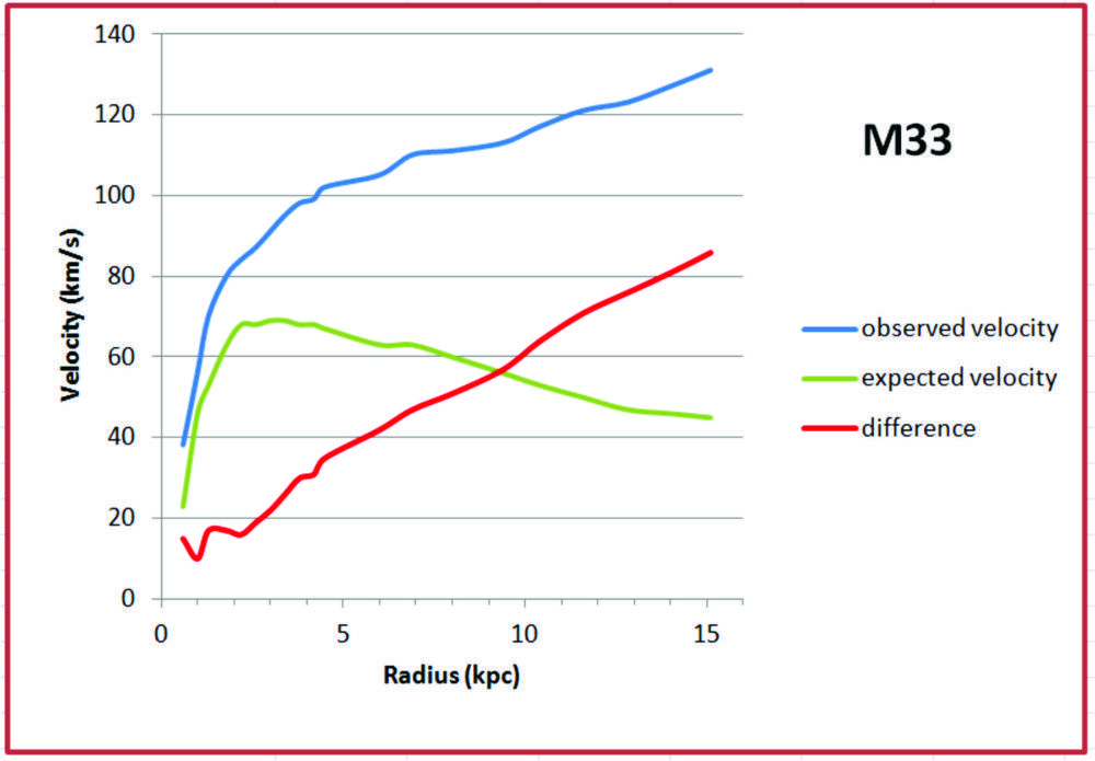

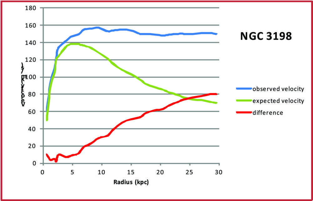

This is a provocative statement because I have known for some time now that there seems to be a correlation between the rotational curve of common spiral galaxies and an imaginary and simple concept of a "rotating space" (whether or not such a thing is possible) around the galaxy. To illustrate what I mean take a look at these two graphs of galaxies NGC3198 and M33. The blue lines are the observed rotational curves of the galaxies, the green lines are the expected curves if no dark matter existed in these galaxies, and the red curves, are the differences between the green and blue curves. The interesting feature of the red curves is that they approximate a simple y=kx line.
241801
241802
These graphs do not represent anything in Konno's paper, I put them here to illustrate the reasons for my original questions and why they are not idle questions. If the space surrounding a galaxy as a whole rotated with the galaxy (represented by a line y=kx) then from the perspective of an observer outside a galaxy devoid of DM, it would appear to rotate as represented by the blue line.
So from my limited understanding it seems that Konno is using the Chern-Simon gravity well effect to illustrate how such an effect can cause a distortion in our observations of a rotational curve.
The difference of course between my illustrations is that I am just taking a foundationless idea of a rotating space around a galaxy to show myself what would happen if such an idea was actually based on real science such as the Lense-Thirring effect or perhaps a new solution to GR that allows my foundationless idea to actually have some foundation.
I hope I have clarified why I am asking the questions I have in my first post.
