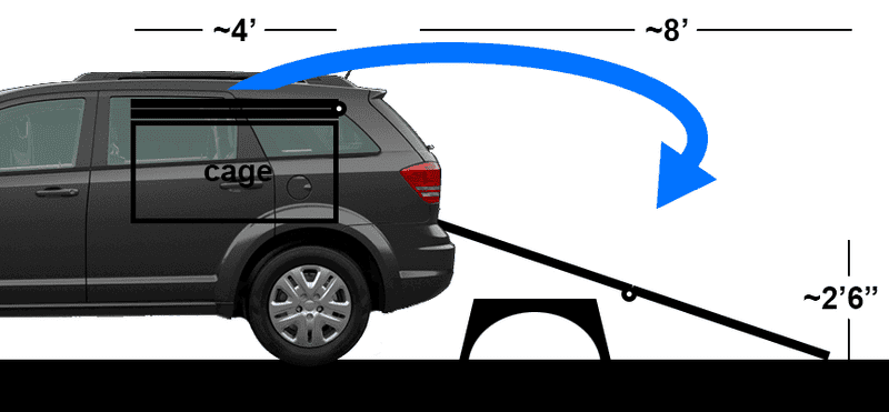

I want to build something to help my poor stumpy-legged dog into the hatch of my car.

She is juuuuust too short to be able to jump into hatch of my Dodge Journey (where the cage is in the back). I will be transporting her a lot more in the near future and I'd like to ensure it goes safely and without potential injury.
I could, perhaps, being her in through a side door it the back, but that leads to safety/control complications . Back hatch is better - easier to access the cage and leash her.
Which would be better for a dog? A ramp? Or just a step? What do they prefer?
The portable cage itself is about four feet long, so that will inform my dimensions, so I can slap the lift-er-up-er of-choice to the cage for compact storage.
I'm not sure if a 2.5' rise over 4' would be shallow enough, so I could double the length of the ramp to about 8' with a hinged arrangement.
Details such as the hinge, attachment points and anti-slip strips/frets(?), etc. can hashed out later.
On the other hand, maybe a step stool is just simpler and more readily available ...

Have you tried a carpeted ramp? That will make it a lot easier for her to "hold on" going up and down the ramp. It may also help to have small sides on the ramp to increase her confidence when walking up and down the middle of it. I've made wooden motorcycle ramps in the past by ripping a dado down the middle of a couple of 2x4s and gluing them to the edges of a plywood ramp (forming a basic "I" beam). If you did something similar and tacked some carpet on the top surface, that might make a nice comfortable ramp for her.
Edit/Add -- I think that a carpeted ramp can be a fair amount shorter than a plain ramp, since she can hold on while going up and down the steeper ramp. That should help to fit it in your car.

The cage is about 4 feet long, so my plan for a ramp is to have it hinge to 4 feet long and I can just throw it in next to / on top of the cage.

Why not try a number of ramp lengths or even a telescopic arrangement, to vary the length and find the shortest ramp that doggie could manage. An experiment involving doggie treats could be arranged.
