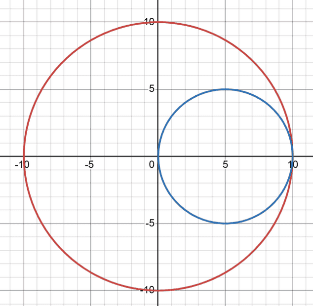

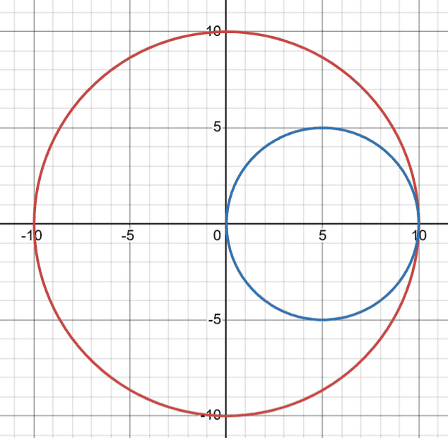

Let R be the region which lies inside the circle ##x^2+y^2=100## and outside the circle ##x^2-10x+y^2=0##
a) Sketch the two circles and shade the region R in your diagram
b) Evaluate the integral ##\iint_R \frac{1}{\sqrt{x^2+y^2}}~dA##
##\iint_R f(x,y)~dA=\int_{\alpha}^{\beta} \int^{b}_{a} f(r,\theta) r~dr~d\theta##
##r=2a \cos\theta+2b\sin\theta##
The polar form of ##x^2+y^2=100## is ##r=10## and polar form of ##x^2-10x+y^2=0## is ##r=10 \cos\theta##
Graph on a coordinate grid with axes from -10 to 10: a large red circle of radius 10 centred at the origin, and a smaller blue circle of radius 5 centred at (5, 0), passing through the origin and (10, 0).
My idea is to divide the working into two parts:
1) find the integral in 1st quadrant and multiply by 2 to include the region in 4th quadrant
2) find the integral in 2nd quadrant and multiply by 2 to include the region in 3rd quadrant
Integral in 1st quadrant:
$$\int_{0}^{\frac{\pi}{2}} \int^{10}_{10\cos\theta} \frac{1}{r}r~dr~d\theta$$
$$=\int_{0}^{\frac{\pi}{2}} \int^{10}_{10\cos\theta} dr~d\theta$$
Integral in 2nd quadrant:
$$\int_{\frac{\pi}{2}}^{\pi} \int^{10}_{0} dr~d\theta$$
Am I correct? Thanks
My strategy is integral in red - integral in blue.

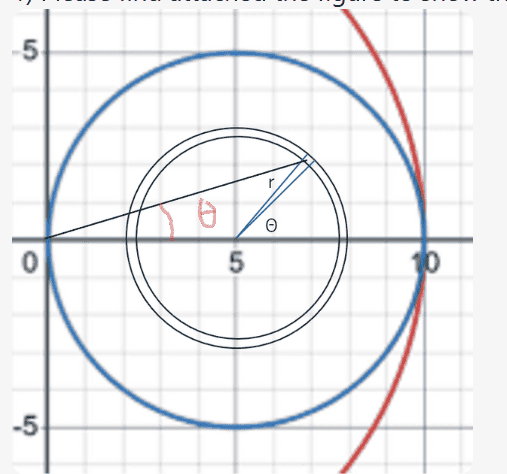

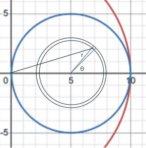

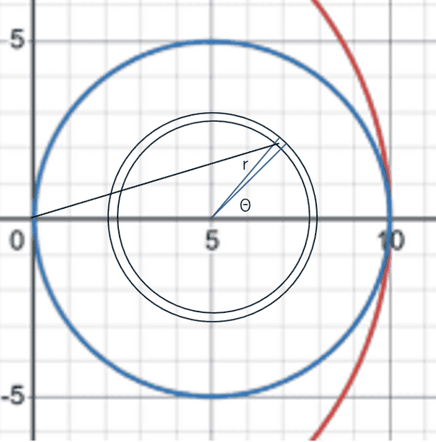

1) Please find attached the figure to show the integration
Geometry diagram of a blue circle centred at (5, 0) with radius 5, passing through the origin, with a red curve on the right and two concentric black circles around (5, 0), with a radius r and angle theta marked from the centre.
2) Sure, but it is not a solution to the problem.
3) Let us check your method and mine. What is the result value ?

The angle in my integral is as figured whatever name it could have.
If I use ##x=a+r\cos\theta##, the angle is always measured from the center of circle?
If you do parametrize the blue circle as [itex]\{(5 + r\cos \theta, r \sin \theta) : r \in [0,5]. \theta \in [0, 2\pi)\}[/itex] then you end up with [tex]\iint_{\mbox{blue circle}} \frac{1}{\sqrt{x^2 + y^2}}\,dx\,dy = <br /> \int_0^{2\pi} \int_0^5 \frac{r}{\sqrt{(r + 5 \cos \theta)^2 + 25\sin^2 \theta}}\,dr\,d\theta[/tex] which is a much less tractable integral than [itex]\int_{-\pi/2}^{\pi/2} \int_0^{10 \cos \theta}\,dr\,d\theta[/itex] using the parametrization [itex]\{ (r \cos \theta, r \sin \theta) : 0 \leq r \leq 10 \cos \theta, -\frac \pi 2 \leq \theta \leq \frac \pi 2 \}.[/itex]
