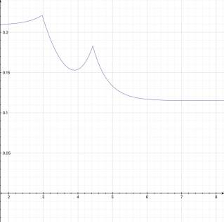

I have calculated this curve (horizontal axis pH, vertical axis solubility) from the constants given by these authors.

For some clarifications you ask: by "critical point" I mean a kink where the solubility curve changes slope.In both cases, the simple case of simple salt treated in the book, and the more complicated case with the 2:1 complex, I am saying that at pH above the high pH kink, [ B] is constant, below the low pH kink [ BH+] (and Cl-) is constant.
"On the book it says that "for pH values <4.5 the solubility of the 3tc does not increase linearly with a slope equal to -1 as would be expected if the base body was constituted by the free base" ... To me it se.ems however that solubility decreases linearly with a +1 slope but is only a supposition". Increasing linearly with -1 slope and a decreasing linearly with +1 is the same thing. However the book is not right in saying that this is with pH, it is with [H+].
As for thinking about the 2:1 complex we solubilities and tendencies, this is quite difficult at first, so I didn't; I just calculated. One should try and make intuition and calculation coincide and reinforce each other. But sometimes one comes first and sometimes the other. In fact I found some qualitative insights that the calculation led me to only last night extremely interesting. This solubility curve has a minimum. And the calculation shows that this at this minimum [ B] = 2[Cl-]. When you think of it this is obvious, or at least plausible-sounding. The composition of the precipitate is B2HCl. So you could think that the solubility of a salt like this is minimum when the solution composition is exactly in the proportions of the precipitate, that solution contents to one side or the other of the proportion do not contribute to precipitation. I had not been aware of such a principle before now.Not completely sure of it yet, or how far it extends, I have a little problem with the H. But it seems we may have a principle for rationalising precipitates like this; is there anything in your book about it? Is any forum reader more familiar?
And still more. The above tells you that at this minimum [ B]/[BH+] = 2. Which gives us that
pHSmin = pKa - log 2
Which gives pHSmin = 3.89. Look at the curve, we seem to have very good agreement between theoretical production and experimental results! A very interesting system after all I'm finding.

What you are doing wrong is resisting writing out just what the whole problem as in the homework template section 1, which could be done in about the same space and time as the above. Followed by sections 2 and 3. I do not know what is stopping you doing this. It would save me time and effort if I just did this for you, but it would be fairly unprecedented on this forum that the homework helper wrote the question in place of the student. I am only persisting because this problem is an interesting extension of ones we already frequently treat here, in which interesting things, challenges and even principles seem to emerge.
For what it is worth I calculate the pH at the high pH critical point to be 4.42. I am taking B0 to be 0.115 from the graph in the publication. Above that pH things are exactly as in the theory and equations of your book for the simple case, so any strange result is no doubt due to some banal mistake in the calculation. Below that point [ B] is no longer equal to B0.

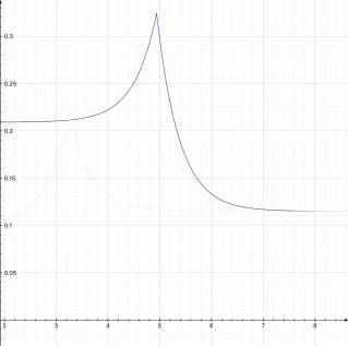

To make it clear, the equations predict solubility curves like this.

Exact! This is the typical solubility curve of a weak base. At very alkaline pH, at least 2 units higher than pKa, [ B ] >> [BH +] and [ B ] is about S0. At pH = pKa la [ B ] = [BH +] and at pH less than at least 2 units with respect to pKa we have that [BH +] >> [ B ]. In this case a further plateau is reached in which the solubility of BH + becomes equal to that of the BHCl salt. The graph of the 3tv is particular because it presents an anomaly in the behavior and consequently in the solubility curve. Moreover, it seems that this effect is due to the use of HCl (it is demonstrated by adding KCl and seeing that due to the presence of the common ion the solubility is further reduced) and not of other acids.

The corresponding curves have the general appearance as in #38 *

I had to illustrate the general appearance of these curves in #38 because there are actually no adequate illustrations of it in the textbook extract given by the student. Such curves have a characteristic feature – the vertical distanceFrom the peak singularity to the height where the curve levels off at low pH is equal to B0. Student should be able to work out why, and why this corresponds to the formula which may also not be evident at first sight. At first sight also the textbook curves 34.2, 34.3 seem to be missing this unavoidable feature - at the top they look just flat. But this is because the solubility is being expressed logarithmically – there are three orders of magnitude difference between B0 and the concentration of a saturated salt solution, so the low-pH dip is practically not noticeable.The vertical coordinate in the case our problem (fig 34.4) is on the other hand linear.
