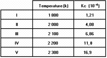

For the chemical equilibrium [tex]N_{2(g)} + O_{2(g)} \rightleftharpoons 2NO_{(g)}[/tex] , the following values were found for the constant Kc (chemical equilibrium constant), at the indicated temperatures:
(The table is attached as an image)

Table in text format:
    Temperature (K)    Kc (10^-4)
I   1800               1.21
II  2000               4.08
III 2100               6.86
IV  2200               11.0
V   2300               16.9
