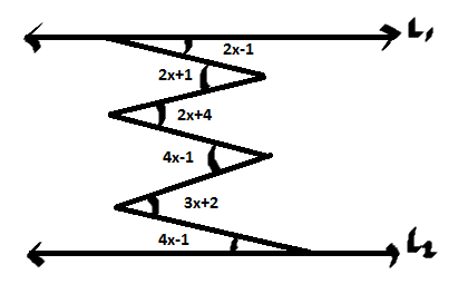

Find x. L1 and L2 are parallel
choices:
a)2°40'
b)2°30'
c)2°45'
d)2°15'
e)2°20'
Σleft∠ = Σright∠
2x+1+4x-1+4x-1 = 2x-1+2x+4+3x+2
10x-1=7x+5
3x=6
x=2°
Not sure how the answers include minutes '
Maybe I'm overlooking something?

I get the same result. Maybe an error in the book.
Yeah, that's what I think too. I'll leave this open just in case anybody has anything to add. Maybe another way of solving?
Quite possibly they made a typo when labelling the figure. You might be able to make a simple change to one of the coefficients or constants in the diagram to have it give their desired answer. :smile:
