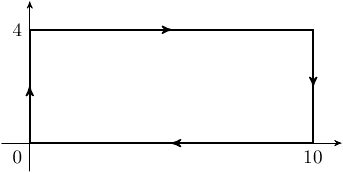

How can I draw a rectangle oriented clockwise on the complex plane with vertices on (0,0), (0,4), (10,4), and (10,0)?
I am guessing the tikz package needs to be used but I am not skilled in making pictures.
If you say \usepackage{tikz}, then you can do
Code:
\tikz\draw (0,0) -- (0,4) -- (10,4) -- (10,0) -- cycle;

What do you mean by a rectangle "oriented clockwise"?
I am sure you can easily do this using other LaTeX packages, but I don't know them very well.
Clockwise is the path you would take around the rectangle.
Ok so that worked but I also want the rectangle on the coordinate axis with arrows along the path and the axes labeled at at 0, 10 and 4. Is there a way to make the rectangle not as big on the pdf?
Well, after a rectangle is finished being drawn, nobody can tell whether it was drawn clockwise or counterclockwise. So I don't see the meaning in stipulating that it is oriented clockwise.

I need arrows on the rectangle showing its orientation of clockwise.

Yes, and besides shortening the notation, this option causes TikZ to create a proper join between the first and last segment. Here is a picture from TikZ manual.

Here is the code for a rectangle with arrows.

This example uses the scale= option, which can be used in each \draw instruction individually or can apply to the whole picture if specified after \begin{tikzpicture}. It affects the specified coordinates, not the line lengths. The option -> adds the arrow tip only to the end of the path, so the rectangle has to consist of several paths.
A more sophisticated way is to use the decorations library.

One advantage is that this allows using the cycle construction, which, as said above, create the correct join at (0, 0). I agree that the syntax of the decorations is rather confusing. (Smile)
