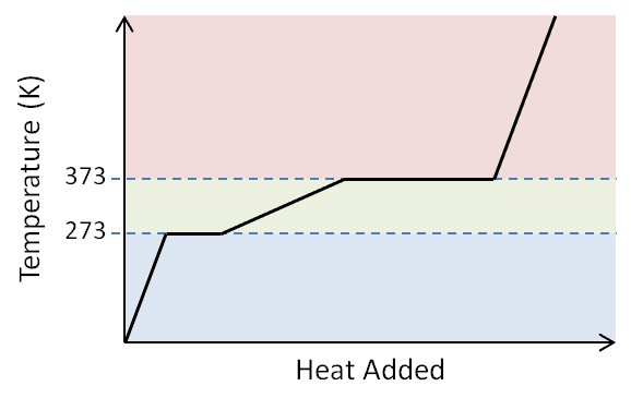

Now, I have one more issue that I'd like to bring up. In many of your calculations, you calculate the amount of heat contained in the water by multiplying the amount of water with the heat capacity of water and its absolute temperature. This equations assumes that the amount of heat contained in the water is directly proportional to the temperature but this assumption is not true.
Below is a diagram (not to scale) illustrating the temperature of water as more heat is added to the water (starting from absolute zero):
As you can see, there are regions where the temperature of the water increases linearly with the amount of heat added. These regions correspond to the three phases of water: solid (blue region), liquid (green region), and gas (red region). At the boundaries between these regions, however, the temperature of the water remains constant even as more heat is added. These correspond to the phase changes (i.e. melting and vaporization) and the latent heats associated with these phase changes. In these regions, the added heat does not go into speeding up the particles to increase their temperature, but instead toward breaking up intermolecular interactions between water molecules.
The diagram clearly demonstrates that the heat contained in a certain amount of water is not directly proportional to temperature. There are certain regions where this assumption holds true (for example, in the region between 273 and 373 K), but once you move outside these regions, the assumption breaks down.

I understand what you are saying, and it leads me to wonder why my method worked then.
When I calculated the final temperature of the water I, like you said, assumed that all the heat contained in the water was just a function of it's temperature, i.e. q=C*T. But really, if you start with water at 0K and bring it up to 293K, qtot=C*T + qfus
So when I just used qtot= C*T, and then subtracted the heat required to melt the ice, why did it give me a correct final temperature? I assume it is because in correcting for my error, something else would be changed that would make the answer stay the same, but I am not sure what that would be.
EDIT: Actually, does it have something to do with the fact that since I am calculating the heat change for a temperature change only, with no phase change included, I can use q that is only involved in changing the temperature, i.e. just q=C*T?

Yes, the qtot values you calculate are all off by the same constant amount. However, because this constant stays the same between 273K and 373K and because your calculations only relate changes in heat to changes in temperature, the constant ends up getting canceled out.
