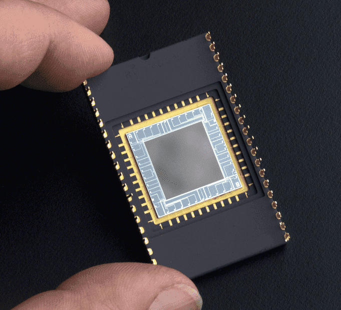

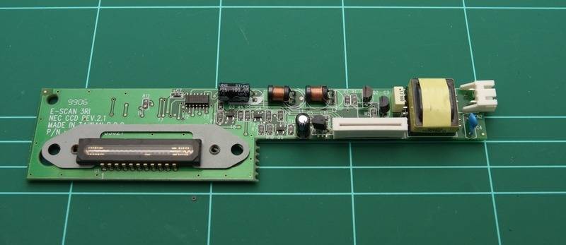

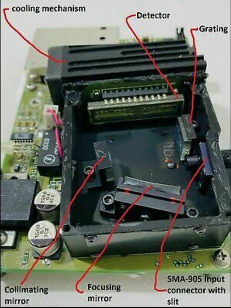

I want to open up a spectrometer to see how the inside looks like. Is it true that the CCD in spectrometer is more sensitive to dusts than normal camera CCD such that even a small speck of dust can cover the CCD pixels and the user will get holes in the spectrum? The following is example I found in the net:
Whatever, I want to open up one and look inside. If I use a normal air purifier in the room which uses HEPA filter and blower. Would it really diminish dusts in the room or just circulate it?

You are not going to learn how to build a CCD by simply looking at one with your naked eye. Try it with this photo.

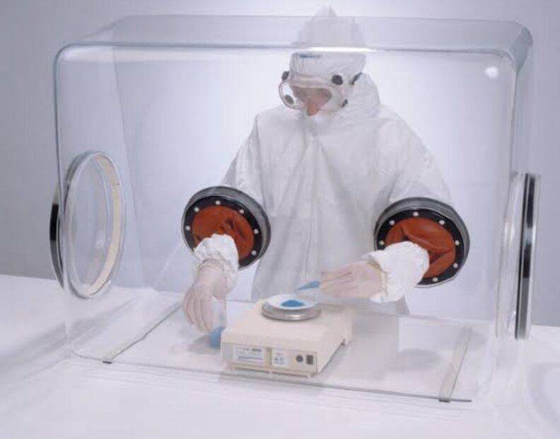

I'd like to know what kinds of dusts can still get into these glove boxes. I guess you can use these on sensitive equipments.
[Link to photo website added by Mentor from a later reply by OP]
https://www.thomassci.com/Miscellaneous-Product-Bel-Art-Products/_/41905020-IRIS-PORT
Yes, but probably overkill. Also, there's no engineering of airflow or filters. So, with lots of use it may accumulate a lot a crap. Also unpleasant to work with.
You'll do better with a laminar flow hood. This example is for microbes, but the idea is the same (I liked the airflow drawings), you can skip the antiseptic stuff like UV lights.
BTW, why's that dude dressed up like that when he's mostly on the outside? You can always spot a photo designed by marketing types, LOL. That's the cleanest, emptiest lab I ever saw.
Good point! And it's even worse -- usually you see built-in gloves in such an enclosure, but this technician is reaching through some sort of portals with gloved and gowned hands instead. Weird.

Because the CCD is linear (1D) the occlusion of a pixcel may be important. But the good news is that there will be no surprises. A bad pixel will easilly be flagged and not lead to bad data...just missing data. There is a lot of overblown rhetoric about optics because parts of it are pretty interesting and slightly esoteric The cleanliness required for a spectrophotometer is not particularly stringent in today's world.
You can find lots of obsolete spectrophotometers for dissection. For instance I have three Ocean Optics ISA bus -spectrophotometer cards on my bench inside a Win 95 PC. Old School. They work fine but I'm sure they can be bought cheap
