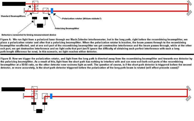

Ten years ago, I posted a long rambling post concluding with a thought-experiment on Usenet, and got no useful feedback. I'd like to try again here. I'd like to post a link to the original post, as it includes details on how I'd go about measuring the effect that I predict, but I don't seem to be allowed to post urls yet. Instead, I'll include a simple drawing that will preclude any need to even read the original post. It involves a simple interferometer using any long-coherence CW laser. Forgive my primitive drawing skills and terminology. If you find quantum physics at all interesting though, I hope you'll have fun considering my thoughts and correcting them as necessary. In the image below, nothing is to scale, and I pulled my distances out of a hat so to speak, but that should not affect the principle I'm trying to understand. If the text looks blurry, maximizing the page should fix it.

I read your attachment, and you seem to have a mixed understanding of interference. For the interference pattern to happen you must have some kind of slit, because without that slit, you will not get the wave pattern from the photons. I have a pretty solid understand of wave-quantum-particle mechanics but I might not be understanding your experiment much yet. Explain how your beam splitters work and I might understand a little better. But, what you were saying about sending a signal that goes backwards through time, what would this do? How could it be applied for anything?

I don't get it.
First of all, what is a "long-coherence CW laser"?
Secondly, why is this any different than the many Mach-Zehnder-type interferometer experiments that have been done? See, for example, T.L. Dimitrova and A. Weis, Am. J. Phys. v.76, p.137 (2008).
Zz.
Hi ZapperZ. I thought CW was a pretty standard laser term. It means "continuous-wave", as in "not pulsed", like a standard HeNe. "Long-Coherence" means the waves remain in phase over a long distance, allowing interference to occur with large path-length differences. Perhaps I should have been more specific and said "long coherence length", but I though it was obvious.
And the drawing does not depict the experiment per se (though, I did state my original post on usenet contained an idea as to how to measure when the pattern disappears vs when we actually block path B). It is, as stated, a typical Mach-Zehnder interferometer. My question was, if we block the beam in path B 45ns into the light's journey, when does the pattern disappear at the screens (considering that path A's journey is only 5ns total and that the light in path A cannot interfere with it's path B counterpart because we block path B...40ns after the path A light reaches its target)?

Hi AzonicZeniths. The beamsplitters are standard cubes. You certainly can get wave patterns with cube beamsplitters (and plate beamslitters for that matter) as I've recorded holograms with them. What would this do?! Proving that the pattern disappears before we actually block path B would shatter beliefs about cause necessarily preceding effect on the macroscopic scale for one thing (and that's good enough for me). And if it were possible, creating chain reactions of such signals would change the world in more ways than I can imagine, but I'll wait until I find out if it's possible before I go speculating about that, heh heh.

PS: @AzonicZeniths: I was thinking about what you were saying about slits. To clarify, under ideal circumstances, in a Mach-Zehnder interferometer, light would interfere destructively at one exit port of the recombining beamsplitter and constructively at the other exit port. Just so you know, I consider the total absense of light at one exit port due to interference as a "pattern"...that is, I'm not expecting the classic double-slit pattern, though a slight shift in angular geometry of the setup can bring about such a pattern...but I know what you mean, and I know my terminology leaves much to be desired.

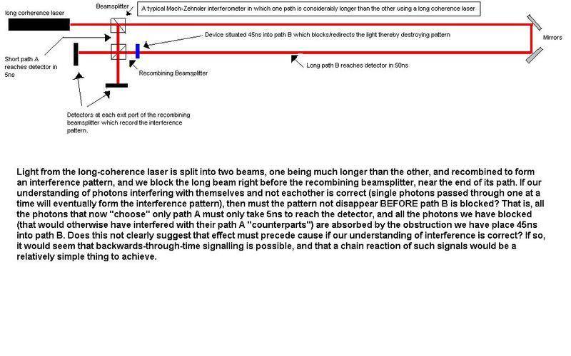

But when photons reach the end of one path (detector or obstruction), the wavefunction collapses, the photon is localized, and since we know the exact length of each path, is it not determined exactly when they would have reached the end of the other path had they taken it? It's not like the speed of light is going to change in one path in order to preserve the pattern so we can't make effect precede cause...Or are we back to the indistinguishability thing again? It feels like we're supposed to believe nature actually cares what we know, like some program designed to foil our every attempt to tamper with it. I don't want to believe it, heh heh!
Well... by that reasoning you could time how long the photon took to be detected and work out which path it took without ever actually measuring the position at an intermediate point.
Would anyone care to explain why you can't do this?
Well, because there's no way to tell when the photon was emitted or left the laser cavity unless you could trigger the emission of a single photon and measure the timing between triggering and absorption, which by itself, couldn't really be considered an interference pattern. We could, I suppose, do this many many times and see if a pattern still emerges though. Not quite as dramatic as what I'm proposing (trying to make the pattern disappear before we block path B), but I do wonder if it's possible.
Here's an image depicting how I'd try to measure the timing if it helps. Again, maximize the image if the text is blurry. I hope I didn't leave out anything obvious. Again, the laser is a continuous wave laser with a long coherence length, but importantly, is also linearly polarized (pretty standard fare...a typical HeNe could fit the bill).

There are picosecond pulse lasers. A lot of filtering could bring the average photon density down to 1 per pulse. It's feasible, if not practicle.

There are some pretty good single photon sources around, they are not completely deterministic and the fidelity isn't 100%, but they are getting there. Quantum cryptography actually requires deterministic single photon sources in order to be completely secure, so there is a lot of money being spent on R&D in this field at the moment.

I really do wish I'd posted the image I uploaded in post #22 instead of the one I uploaded in post #1 though. It might not make any difference, but it might better depict where my thought processes went wrong. I think that where my thinking is flawed is in assuming that once the wave-function collapses for the photons in either path (eg. we divert path B to detector 2 in the second image), the time of emission of the photons in either path becomes irrellevant. Obviously I was wrong, and I have to spend some time trying to understand all of this.
I can't thank you people enough!
Edit: I did make major typo in the second image...where it says "at the same time" I should have said "as a result"...but hopefuly it was obvious.
