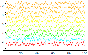

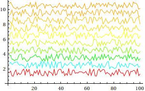

I want to take a set of lists {list1, list2, list3, ..., list N} and plot them with color according to the following rule:Color set = { Hue[1-0.] , Hue[1/2], Hue[1/3], ... Hue[1/N] }
For any arbitrary number of sets... where Hue[1-0.] is used because Hue[1] is not defined.
Something like the following?
Code:
n=10; k=100;
data=Range[1, n] + RandomReal[{0, 1}, {n, k}];
hues=Table[Hue[1/j], {j, n}];
ListPlot[data, Joined->True, PlotStyle->hues]

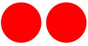

I'm not sure what you mean by Hue[1] not being defined
Code:
GraphicsRow[{Graphics[{Hue[1], Disk[]}], Graphics[{Hue[1.], Disk[]}]}]
