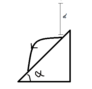

I am bad at making diagram on my computer hope it will help a bit .
Ok, but how do you get the range to the second bounce?
there was a component of gravity perpendicular to plane and one parallel to it so I used perpendicular one to find the time of flight and parallel one to find the range as shown in #3
Ok, very good.
I agree with your answer except, as I mentioned, it says d is the distance from the plane; it doesn’t say the height above the plane. But that would make the answer even larger, so doesn’t help.

what does "from the plane means??" ball is released above the inclined plane so won't it be the height above it? or are the terms "inclined plane" and "plane a bit different" like inclined or horizontal?
The distance from a point to a plane is generally taken to be along the shortest path, i.e. normal to the plane.
haruspex said:
Ok, very good.
Yes it does, tan is larger than sin by a factor 1/cos, which just happens to be the same factor by which the vertical distance is larger than the shortest distance.

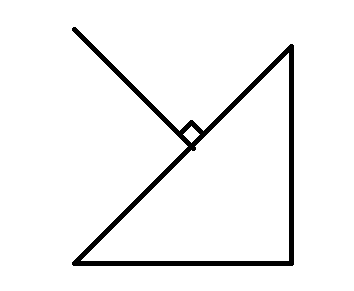

does it means perpendicular distance like this??
IamVector said:
does it means perpendicular distance like this??View attachment 258622
Yes, that is typically what you mean when you say "distance to the plane", i.e., the shortest possible distance to a point on the plane.
ohk
that is why its tan except sin, I completely misunderstood it thanks for help : ) .
