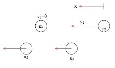

Two identical masses collide. one is at rest. what are their final velocities.
The relative velocities before and after the collision are identical:
##v_1-v_2=-(u_1-u_2)##
I draw the final velocities in the same direction:
[tex]\left\{ \begin{array}{l} mv_1=mu_1+mu_2 \\ -v_1=-(u_1-u_2) \end{array} \right.[/tex]
It gives $$u_2=0$$ which isn't true, u1 should be 0.
And more, i can switch between u1 and u2 in the drawing and it will also be good since they are drawn in the same direction, so, how do i know who stops?
I get this answer also if i use the conservation of energy formula instead of the relative velocities formula.
If i draw u1 backwards and change the formula in accordance:
##\left\{ \begin{array}{l} mv_1=mu_1-mu_2 \\ -v_1=-(u_1-u_2) \end{array} \right.##
I again get the same result: $$u_2=0$$
Apart from the question i posed, do i have to assume a direction and then write the formuls accordingly or i have always to write:
##\left\{ \begin{array}{l} mv_1=mu_1+mu_2 \\ -v_1=-(u_1-u_2) \end{array} \right.##
The left hand side of the second equation should be ##v_1##, not ##-v_1##.
Thanks, it solved it.

No, you will not get different answers by doing it different ways. The statement ##u_1 u_2 = 0## simply tells you that either ##u_1## or ##u_2## is zero after the collision, both of which are perfectly valid roots (##u_2 = 0## corresponds to the balls not having collided yet).
The equations you have are symmetric in ##u_1## and ##u_2## so if ##u_1 = 0, u_2 = U## is a solution, then also ##u_1 = U, u_2 = 0## must be a solution.

You made an error in your substitution. ##u_1 \ne v_1+u_2##.
