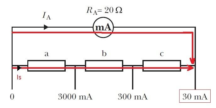

We have an ammeter with 20Ω resistance and a range of 10mA or 0.01A.
The different ranges are 3000mA, 300mA, 30mA.
Calculate the shunt resistors a, b and c.

Circuit schematic of an ammeter with internal resistance R_A = 20 Ω in parallel with resistors a, b and c, with current tap points labelled 3000 mA, 300 mA and 30 mA, and a red current path drawn through the circuit.

I found the equivalent resistance for all shunts:
Rn = Ra / m - 1
Rn = 20 / 3 - 1 = 10Ω
In parallel the voltage is the same in all resistors, but a, b and c are in series and have their own voltages out of our Ua = 0.2V.
How can I find the voltage for a, b and c?
Otherwise I can't calculate each resistor.
The answers on my answer sheet are:
a = 0.1Ω
b = 0.9Ω
c = 9Ω
So indeed the equivalent resistor is 10Ω.
I hope someone can help me with this.

Case m1 is easy, right ? Can peek at the previous thread to help you find Ra+Rb+Rc .
Case m2: 10 mA through Rc + 20 ##\Omega##, 290 mA through the parallel path of (Ra+Rb). Gets you a ratio.
Case m3 gets you a ratio too. Two ratios and one sum: means you can solve for the three unknown Rx

You'll need to create a set of simultaneous equations to solve. For example, for the first case you found that the sum of all the shunt resistors is 10Ω : ##R_a + R_b + R_c = 10##. You need to find similar equations for the other two cases and solve for the individual resistance values.Edit. Ha! I see that BvU beat me to it!

Okay, so I came up with this:
Ra + Rb + Rc = 10
30Rc = 270
300Rb +300Rc = 2970
I used the matrix method:
A
1 1 1 Ra 10
0 0 30 ⋅ Rb = 270
0 300 300 Rc 2970
Determinant of A = -9000
D-Ra
10 1 1
270 0 30
2970 300 300
Determinant of D-Ra = -900
D-Rb
1 10 1
0 270 30
0 2970 300
Determinant of D-Rb = -8100
D-Rc
1 1 10
0 0 270
0 300 2970
Determinant of D-Rc = -81000
Ra = D-Ra / A = -900 / -9000 = 0.1Ω
Rb = D-Rb / A = -8100 / -9000 = 0.9Ω
Rc = D-Rc / A = -81000 / -9000 = 9Ω
So I think I got it right.
Thanks for your time guys.
