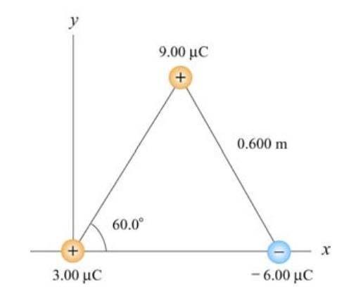

The Q1 is:
Q. 1
Three point charges are placed at the apexes of an equilateral triangle as shown in diagram. Calculate the net force on (a) the 5 μC (= 5 × 10‐6 C) charge and (b) the ‐6 μC charge. Give each answer in the form a i + b j where a and b are the x and y components of the force, respectively. The permitivity of free space is
ε0 =8.854×10‐12 F m‐1 (i.e. farad/metre )
Format of answer lines (on Answer Form) :
Answer 1a: a i + b j units
Answer 1b: c i + d j units

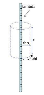

And final Q3:
Q. 3
Use Gauss’ Law to calculate the electric field at a distance ρ (rho)
from an infinite rod carrying uniform linear charge density λ
(lambda) coulombs per unit length. Specify the direction of the
field, choosing between the ρ, z and φ (phi) directions (cylindrical
coordinates).
Hint: Calculate the electric flux through the pillbox as shown in
diagram where the direction of the electric field lines decides which
of the pillbox surfaces (the curved surface or the top and bottom flat
surfaces) contributes to the integral over the Gaussian Surface.
Guys, I know I supposed to give my reasoning and what I think what to do, but I don't have a smallest clue! I am ussually good at physics, but my lecture has changed and this one is...
Please help guys!
