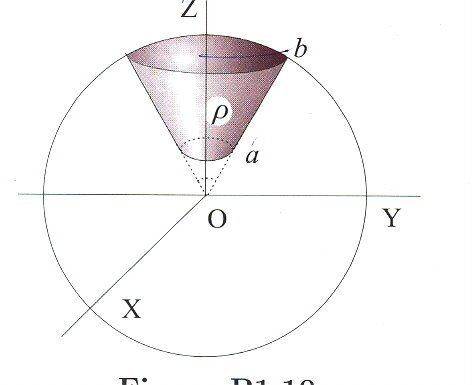

In a sphere truncated sector with an angle of 60 degrees, there is a uniform charge distribution, [tex]\rho[/tex]. Calculate the electric field in [tex](0,0,0)[/tex]. The sector starts in [tex]z=a[/tex] and ends in [tex]z = b[/tex]. The sphere center is in [tex](0,0,0)[/tex].

What is the problem? I don't know if I can integrate using cylindrical coordinates directly or, on the other hand, if I must use rectangular coordinates:
[tex]\bar{E}(0) = \displaystyle\frac{1}{4 \pi \epsilon_0} \displaystyle\int_0^{2 \pi}\displaystyle\int_0^{\pi /6}\displaystyle\int_a^b \rho\displaystyle\frac{\hat{R}R'}{R'^3}R'^2 \sin \theta\;dRd\theta d\phi[/tex]
or
[tex]\bar{E}(0) = \displaystyle\frac{1}{4 \pi \epsilon_0} \displaystyle\int_0^{2 \pi}\displaystyle\int_0^{\pi /6}\displaystyle\int_a^b \rho\displaystyle\frac{-\hat{z}R' \cos \theta}{R'^3}R'^2 \sin \theta\;dRd\theta d\phi[/tex] ?
In first situation, the result will depend on [tex]\hat{R}[/tex], but, in the second one, it will depend on [tex]\hat{z}[/tex]. Which is the correct solution and why?

Some of the errors you have detected are misprints, so I'll correct them. In addition, I thought in spherical coordinates, but I wrote cylindrical ones. Sorry, again. Now I attach an image in order to see how is the situation.

In your first integral, the unit vector should be [tex]\hat{R}'[/tex], not [tex]\hat{R}[/tex]. I assume that's just another typo as you wrote it correctly earlier. You also dropped an overall negative sign.
Other than those errors, both expressions are correct. In the first integral, you're not taking advantage of the axial symmetry of the problem yet. If you plug in the expression for [tex]\hat{R}'[/tex] and integrate, you'll find the x and y components come out to be zero. You can, of course, prior to integration, argue those components should be 0 by symmetry and just calculate the z component. That's what the second integral gives you.

Because of your answer, I understand I should substitute [tex]\hat{R}'[/tex] unit vector by [tex]\hat{x} \cos \theta \sin \phi + \hat{y} \cos \theta \cos \phi + \hat{z} \sin \theta[/tex] and then, integrate. Why I must do it?

You're still missing the overall negative sign, and the unit vector you should be
[tex]\hat{R} = \sin\theta\cos\phi\,\hat{x} + \sin\theta\sin\phi\,\hat{y} + \cos\theta\,\hat{z}[/tex]
I'm not sure about your question about why you would do this. How else are you going to evaluate the integral? Note that the unit vector depends on the variables of integration, so you can't just pull it out of the integral.

That's my trouble! So, I can't pull [tex]\hat{R}[/tex] out because of its dependency.
For example, if I were calculating the electric field in a charged sphere, obvioulsy the field depends on radial direction and there is spherical simmetry, so I could integrate the [tex]\hat{R}[/tex] unit vector. Yes?

Your integral in post 7 has mistakes. I assumed you were just being careless, but your subsequent questions make me question my assumption. R and R' aren't interchangeable, and I think you're confusing yourself by not being keeping track of which is being used where.
There's nothing particularly special about the unit vector. Just like any other quantity in the integrand, if it depends on the variables of integration, you can't pull it out of the integral. It's that simple. If you want to evaluate the integral, you'll need to express the unit vector explicitly in terms of the integration variable.

I think [tex]\bar{R}'[/tex] points at the source and [tex]\bar{R}[/tex] points to where I want to know the electric field.
So, the integral should be:
[tex] <br /> \bar{E}(0) = \displaystyle\frac{1}{4 \pi \epsilon_0} \displaystyle\int_0^{2 \pi}\displaystyle\int_0^{\pi /6}\displaystyle\int_a^b \rho\displaystyle\frac{-\hat{R}'R'}{R'^3}R'^2 \sin \theta\;dR'd\theta d\phi<br /> [/tex]
In this case, [tex]\bar{R} = 0[/tex]. Is it correct?
