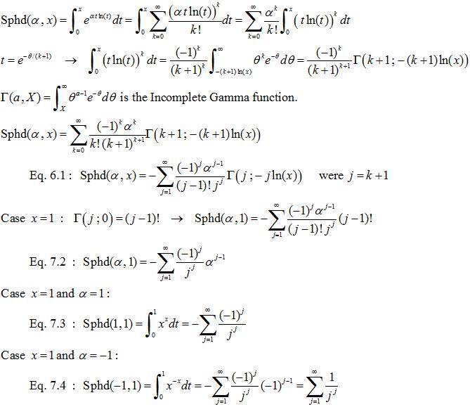

JJacquelin said:
Impressive set of documents! I have a question about the sophomore dream: how would one show that:
$$ \int_0^1 x^{-x} \, dx = \sum_{n=1}^\infty \frac{1}{n^n} $$
