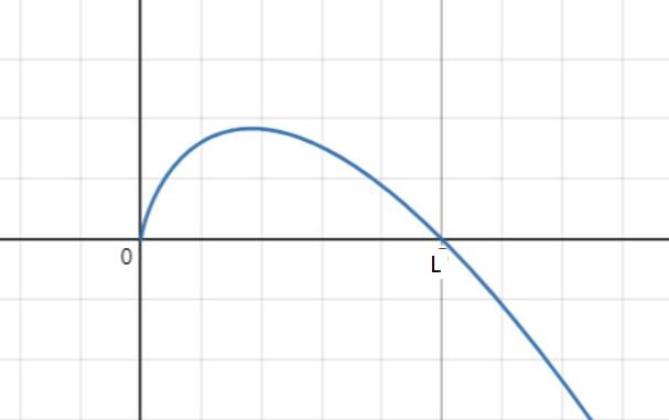

If you got the equation correctly, the graph should look similar to the attached image (plot using https://www.transum.org/Maths/Activity/Graph/Desmos.asp)
