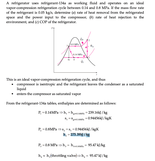

How to get h2?
(see pic)

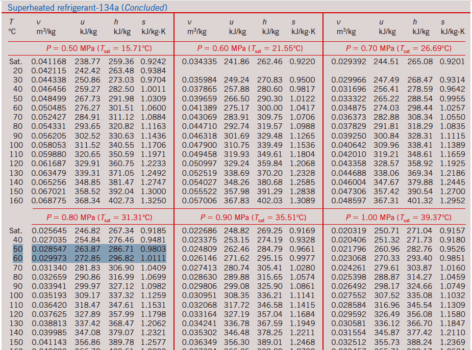

however, how to get h2? it is not on the curve, and neither p or dV is given in the question. Thank you
Ity says P 0.8 MPa on the curve ! You have s,p and can look up T in table A-13
This is table A13, which at P=0.8MPa, s=0.94456, h should be somewhere between 286.71 and 296.82.
However, from the solution, h= 275.39kJ, am I looking at the table in a correct way?
Yes you are. Turns out the phys props have changed slightly.
I have an older edition (2002) of cengel and there it matches better.
40273.660.9374
50284.390.9711
https://www.egr.msu.edu/classes/me417/somerton/R134a Tables.pdf
