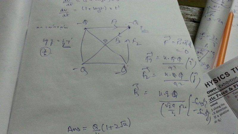

four charges each equal -Q placed at the four edges of a square and a charge q is placed at the centre. if system is in equilibrium the value of q is,
the answer is q = Q/4 * ( 1 + 2(√2)
can anyone please solve this, would be great

this was one of the replies i got, but couldn't understand it, hope it will help

I solved it.I will send a picture I hope it will be not a problem cause its not in homework section

It is clear by inspection that the center charge will be in equilibrium regardless of the value of q.
So the original problem is surely intended to find the value of q for which the four equal charges at the corners are each in an equilibrium. Whether that equilibrium would be stable is a separate question that we need not delve into here.
One should be able to calculate the repulsion on each corner charge from its peers. And one should be able to calculate the attraction of the corner charge from the center charge in terms of the known value Q and the unknown value q. Find q such that the net force on a corner charge is zero and the problem is solved. I believe that is the approach that was taken in the posted answer.
