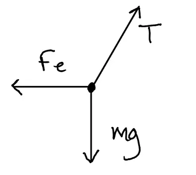

Hi @hmparticle9. To add what's already been said, there are three forces acting on each particle. Can you name them and can you draw a free-body diagram for one of the particles?
##F_e## is the repulsive force from the other charge, ##T## is the tension from the string and ##mg## is the force due to gravity. The above comments are obviously correct: ##F_e## and the other forces point in different directions. I am not sure where to go from here.

With the drawing in mind and given a value for ##\theta##, can you find a formula for ##T##?
With the formula for ##T## in hand, can you then find a formula for ##f_e##?
So I get
$$T \sin \frac{\theta}{2} = F_e \text{ and } T \cos \frac{\theta}{2} = mg$$
Dividing and rearranging I get
$$mg \tan \frac{\theta}{2} = F_e$$
which is exactly what I want?
