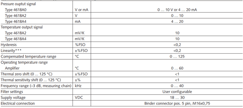

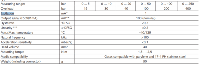

Hi, thse are the datasheets of the transducer (which is a piezoresistive pressure transducer) and amplifier.
I hope they can help to understand a bit more the problem.

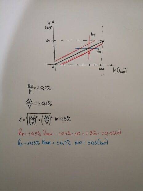

I can try to explain one solution I found but I can't understand very well.
According this solution, we have the characteristcs of the system transducer+amplifier, which is a straight line passing in:
A=(0,0) and B=(p_max,V_max)=(100,10)
The band of error will be given by:
eps=(eps_T^2+esp_A^2)^0.5
where:
esp_T=error of the transducer=0.2%
esp_A=error of the amplifier=0.2%
so that we obtain the results of the following pic
Transducer (first pic)
Amplifier (second pic)
haruspex said:
The output is effectively the product of two functions, the conversion from pressure to voltage followed by linear amplification.
The resulting expected error is therefore given by the f=AB case in https://en.m.wikipedia.org/wiki/Propagation_of_uncertainty#Example_formulae.
Since the two errors are presumed independent, ##\sigma_{AB}=0##.
Thank you so much this is a good starting point. I know how to calculate de standard deviation of a quantity f(a, b). Can you explain me why the system amplifier+transducer can be described as a function f=A*B?
An amplifier, in principle, multiplies its input by a constant to produce an output. If A is the output of the transducer and B is the multiplier then the final output is AB.
