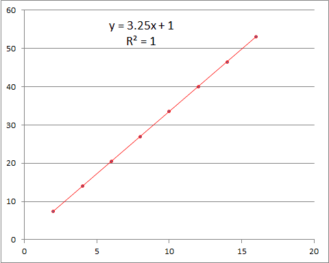

When I look at your results and let excel draw a straight line through all the points 'magnetic field Average', I see a very straight line:
Scatter plot with a red straight-line fit of y against x, from x = 0 to 16 and y = 0 to 60, with the equation y = 3.2167x + 1.3778 and R² = 0.9997 printed on it.
and if I leave out the first point
Scatter plot with a fitted red straight line of y against x, both axes 0 to 20. Label reads y = 3.250000x + 1.000000 and R² = 1.000000. Points lie on the line from x = 2 to x = 16, with y rising from about 7 to about 53.
the line is so perfectly linear, it's astonishing !

Does Excel know about the linear relationship ? It should not !
Did you actually calculate these averages from sets of observations ? Some of the averages are very close to an extreme value :

Even if I use the extremes as data points a nice line is the result:
Scatter plot of red open circles with a black fitted line, y = 3.1625x + 1.5333, R² = 0.967, plotted against x from 0 to 20 and y from 0 to 60.
Then: your theoretical relationship is ##B = \pi I## 10-5 for the field from the 4 cm loop only. Did you notice your lab instructions start with a picture of the Earth magnetic field ? That will have been the same for all measurements: a systematic deviation, not 'interference'.
You measured for currents from 0 to 16 A. Can you still improve your result by measuring from -16 to 0 A as well ? Who knows you may be able to deduce how strong the Earth magnetic field is at the center of your loop -- but then you need to find out the direction as well, and link the result to the orientatioin of your setup.

Ok let me clear some stuff up, I appologise for my way of explaining things so far.
BvU said:
Still trying to understand. Looks as if this is already ordered somehow and to me it seems as if you did not use all of your information
So what happens was this at the very begging of our experiment I count how many times in the 20seconds we saw certain values. I then ask my demonstrator is this was correct, he said don’t worries about building a frequency table for the results as we only have 9hrs to complete a total of 4 section of this lab, so I have to assume that all the values are of equal weight which is why I used the method to calculate the uncertainty on the magnetic field. After I posted my last post I did come to relaise that the uncerity in the amp meter etc are not statitical, the problem that was throwing me was that the uncertainty in the amp meter is ##\pm 0.02a##
BvU said:
And it is strange that the 8 A measurement does not stick out in post #1, but it sure does in post #6. What happens here ?
For this I do not know why in post one it did not have the same value, I have re-done the graph and get the same results as post 7, maybe it was an input error by me.
As perviosuly mentioned I have a hard time differentiating between random errors and systematic.
So for example as in this experiment we use a ruler to measure the distance the probed moved along the x-axis so in my mind I think this is a random uncertainty because my interpretation and best of the measurement could be ##\pm 0.5mm##, so say I moved the probe from 10cm to 11cm and took the following 10.5,11,11.5,10,10,5 etc and workout the SD then, the SD should be 0.5.
However my point of confusion is this because I am not actually measuring it multiple times I am just moving the rod from 10cm to 11cm it dose not matter how many times I move it I will still believe it to move 1cm so surely this means that this is a systematic error as the error will be the same thought all my measurements along the x-axis
Also as seen from my second graph I think what has cause the massive peak in my grpah, I keep thinking that it is to do with the postion of the sensor , but that can't be true as the mag field is always strongest at the centre of the loop, so I am not sure what has caused the massive fluxuations. I mean it could be down to the postion of the probe along the x-ais that would contribute to some but not as big as that, i should not think
