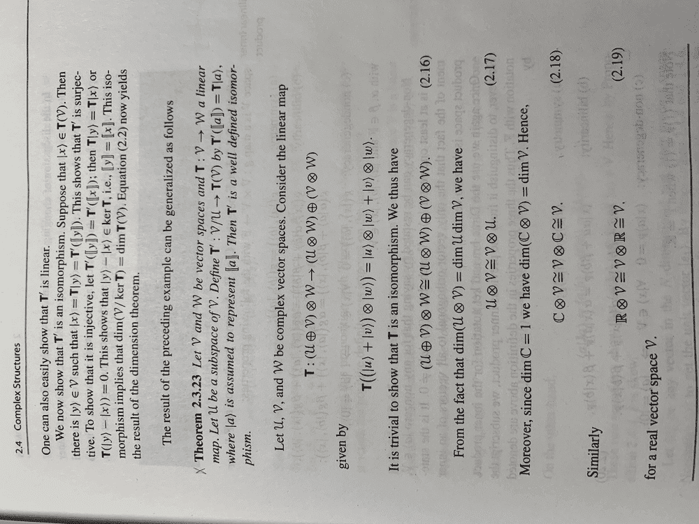

I am reading his excellent book "Mathematical Physics Part 1, Second Edition", which has benefited me a lot in many ways.
However, I have a doubt about the correctness of the theorem 2.3.23, which states that for any subspace U of V, the map T ' : V/U -> T(V) defined by T ' ([a]) = T|a> is well defined isomorphism.
I can not understand this theorem. If the theorem is correct, for any b and a in the same class [a], T(|a>-|b>) must be zero in T(V). That doesn't seem right for any subspace but Ker T.
What do the author really mean?

I think the key point is T' is not a well defined map.
As defined, for any equivalent class [a]=[c]={a, c, ...}, T'([a]) = T(a), T'([c]) = T(c), However, a-c is not guaranteed to be in Ker T (it is in U, but U is not Ker T). As a result, T'([a]) - T'([c]) = T(a-c) may not be zero in T(V). That is [a] = [c] , But T'([a]) != T'([c]), which violates the requirement of a well defined mapping.

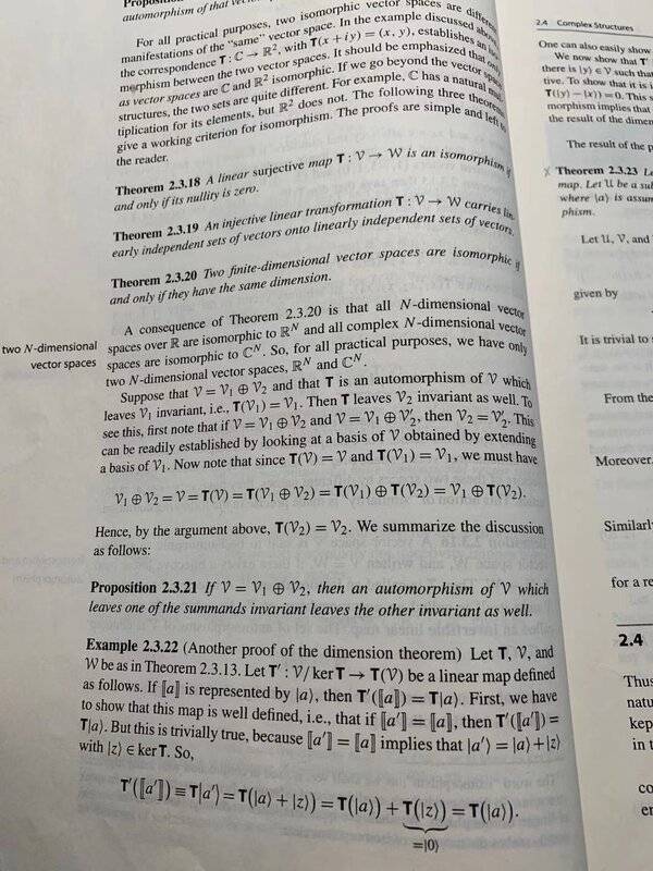

Please see the attached example 2.3.22 in the same book.
@xaos The text syas that ##V/U## is isomorphic to ##T(V)##, where ##U## is a subspace of ##V##. How can that be true for any subspace!

This isn't true. Consider ##T(x,y)=(y,x)## and ##U=\text{Span}(1,0).## Then ##[(1,1)]=[(0,1)]## but ##[T(1,1)]\neq [T(0,1)].##
T((1,1)) = T'([(1,1)] = T'([(0,1)]) = T((0,1)) So they have the same image under T. What does [T(x,y)] mean? The equivalence classes are not in W but in V/U.
The problem is that ##(1,1)## is in the same equivalence class as ##(0,1)##, but ##T(1,1)\neq T(0,1)##. This means that ##T'([v])=T(v)## is not well-defined. Yes, the brackets in ##[T(x,y)]## were a typo.

Even if that ##T'## is well-defined (and this is not mentioned as a hypothesis in the pdf), it doesn't have to be an isomorphism. Let ##T:V\to V## be the zero map and let ##U=\{0\}.## Then ##T':V/U\to T(V)## is well-defined (it's still the zero map), but it's not an isomorphism unless ##V=\{0\}.##

You can't prove a false statement by writing an argument a different way. I gave a counterexample. The condition ##[x]=[y]## does not imply ##T(x)=T(y).## This implication is true if and only if ##U## is a subspace of the kernel of ##T##.

You're assuming that ##T'## is well-defined there. Given an arbitrary subspace ##U\subset V## and an arbitrary linear map ##T:V\to W##, there is no reason why ##U\subseteq\ker(T)## should be true.
