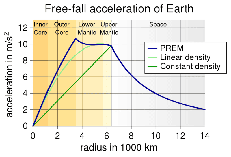

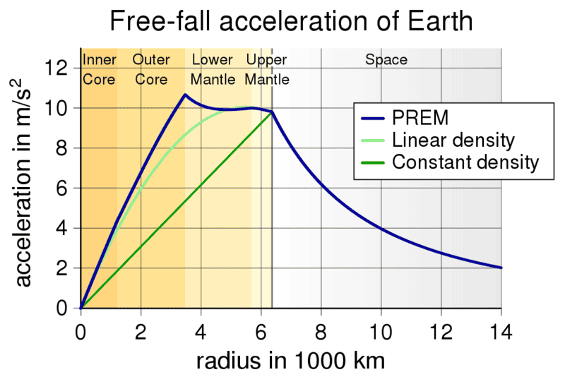

Take a look at the variation in gravitational acceleration inside the Earth here:
https://en.wikipedia.org/wiki/Gravity_of_Earth
The acceleration is approximately constant (##10m/s^2##) from the surface to a radius of about ##3,000km## and reduces linearly after that. This provides the option of a simple model based on two phases for the acceleration Earth. The first phase should be straightforward and the second phase can use the same method as above.
This gives a more accurate estimate for the escape velocity from the centre (for what it's worth!). Here's the graph from the Wikipedia page:

Just to note that the gravitational potential at the center is the area under the curve here. The difference between PREM and constant density is appreciable. The area outside of the Earth radius is easy to underestimate, but it is the same for all models obviously.
I make it about 20%.
