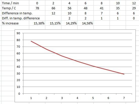

A friend suggests that the rate of cooling is exponential. (i) Show quantitatively whether this suggestion is valid. (ii) Estimate the temperature of the coffee after a total of 12 min.

(b) (i) Can't say that it's exponential, since the increase is not the same in percentage.
(b) (ii) The temperature should be 29 °C, because we have a difference of two twice and a difference of one once. So, I guess every difference should be two times the number: 2 x 2, 2 x 1, 2 x 0.
Spreadsheet table of coffee cooling data: time 0 to 12 min, temperature 78, 66, 56, 48, 41, 35, 29 C, with differences and percentage changes, above a line graph of temperature falling over seven points.
In sum: what's missing in (a) (ii) and is my logic in (b) (i-ii) correct?

What can be said about (b)? I think it should be correct, at least (b) (i) should.
Spreadsheet table of time in minutes against temperature in C for cooling, with differences and percent increase rows, above a line graph of temperature falling from 78 to about 29 over seven points.
Well, as you stated in your first post, the percent increase is fairly consistent at -14% to -15% for the few data points that you have. (The % increase should be negative, as the temperature is decreasing.) The data only has 2 significant figures and you only have 5 data points. So I would say that the percent change in T is essentially constant when going from one time to the next.
I don't know at what level you are doing data analysis in your class. What are the ways that you have been taught to tell if a data set represents exponential behavior?
I based my answer on this video. In the example the change is constantly equal to 50 %. In my case the percentage differs (slightly, but differs), so I would assume that it is not exponential.
And in terms of (b) (ii)? Should the temperature of 29 degrees be correct?
In the video, the numbers were chosen to make the percent change exactly 50% for two consecutive data points. For real data, you cannot expect the data to be perfectly exponential, or perfectly linear, etc. You are just trying to discover if the data is "well described" by exponential behavior, or linear behavior, etc.
For the data in the problem, the percent decrease is fairly constant at around 15%. If you had to pick between exponential or linear behavior, which would you choose?
For determining the temperature at t = 12 s, I would not recommend your method.
