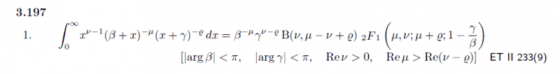

Substituting the CDF of ##a_1## and the PDF of ##a_2## in the integral yields
$$F_X(x)=\int_0^{\infty}\left[1-\frac{1}{1+x(\beta+1)}\right]\frac{1}{(1+\beta)^2}\,d\beta=1-\frac{1}{x}\int_0^{\infty}\frac{1}{\beta+\left(1+\frac{1}{x}\right)}\frac{1}{(1+\beta)^2}\,d\beta$$
Then I used the integral formula attached from the table of integrals. Is there anything wrong in my work?
Using the integration formula attached yields to:
[tex]F_X(x)=1-\frac{1}{x}B(1,2)_2F_1(2,1;3;1-\left(1+\frac{1}{x}\right))[/tex]
where ##B(.,.)## is the Beta function, and ##_2F_1## is the Gauss Hypergeometric function. The constants in the integral attached are: ##\nu=1##, ##\beta=1## which implies that ##\mu=2##, and ##\gamma=1+\frac{1}{x}## which implies ##\rho=1##. I checked the conditions, and they are satisfied. However, the result of ##F_X(x)## must be in ##[0,\,1]## which isn't the case when I evaluate it in Mathematica. Why? I appreciate any help.
