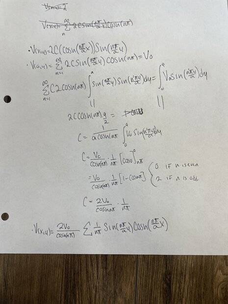

:oops: i totally messed that up. I swore I saw it like that when I looked that up last night.
So i finished solving the problem after correcting my mistake. I used the Fourier trick shown in my book to kind of help lead me through solving this problem.
I guess now is to just choose what n will be in the summation. I believe it should be odd non negative integers because if I have an even number for n, sin will be zero and the whole potential function will be zero.
Does this seem correct?
Your answer doesn’t make sense because you have an n outside the summation.
You can always check the answer to such a question by seeing whether it satisfies all the equations you started with.
(I was also thrown at first by your notation, writing cosn for cosine instead of just cos.)

It is cosh, not cosn. Still, as you say, n cannot be outside the sum of course.
Ok, thanks. I had not read through the development.
To add to that, the sum is lacking any indication what the sum is taken over. Mid computation you have two cases (0 when n is even and 2 when n is odd), the sum should only be over odd n. Unless a sum is over all the range, it is very important to note what the sum is over.
I think that part of @quittingthecult's question is how to determine the values to sum over. The reason for only using odd n offered in post #4 doesn’t look right to me.
Yea I can see having that cosh outside the summation is a big problem. Glaring mistake that I will fix.
I was holding out on identifying what n should be on the summation notation in hopes that I could get some feedback here before continuing.
My post may be a bit convoluted to follow as its not organized as good as can be,sorry about that.
So if I include that cosh into the summation (which I should of course, big mistake of mine). and you say the summation should only be when n is odd, but I have a sin(nπy/a). Letting n be odd is fine for cosh but would make sin go to zero which would make the potential go to zero.
So that's why I am confused about what interval n should be. Choosing odd or even essentially makes the potential go to zero

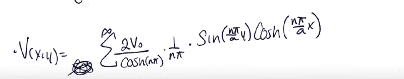

Dang i didnt think about the y. I guess does make a big difference.
So then my answer should be correct, as long as n is in the interval of even numbers in the summation?
I think this is the right answer, as long as I include the interval of n to be even non negative integers.
Not quite sure what you mean by that. The question to settle is whether the set of values for n should be (nonnegative) even, odd or both.
Consider symmetry and the x=a boundary. Try n=1 and n=2.

Well when x=a, odd makes the potential negative and even makes the potential positive.
So I guess that means it can be even and odd ?
x=a is a boundary, with y ranging from 0 to a. What does that graph look like for n=1 and n=2?

##1-\cos(\pi n) = 0## if ##n## is even seems pretty right to me.
Ah... I was looking at the text, which says "sin will be zero". It should say "C will be zero".
I agree that that needs some work. Essentially, OP has the right result but identifying the wrong reason for it when the actual reason is in the notes.
Yea that that's a huge mistake on my part. sorry about that.
