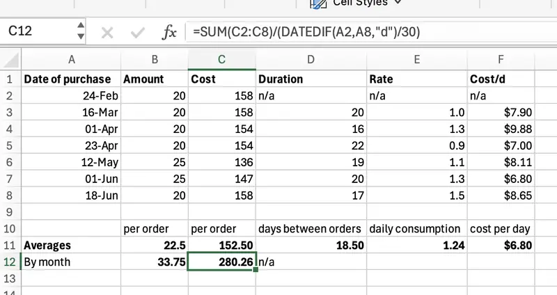

I've got the averages worked out. Even though there's seven orders, I can't count them all because either I don't have the consumption rates for February, or I don't have the consumption for June yet.
Where I'm stumped is C12: converting the cost to a monthly average, since so far, it's all based on orders approximately 18.5 days apart.
I am calculating the total cost and dividing by how many days have passed. (=SUM(C2:C8) / (DATEDIF(A2:A8,"d")/30) )
But $280/month is too high.
My sanity check says it should be approximately $250. I get this by taking the average cost per order ($152 (C11)) and dividing by .6 (total duration/30), which will give me approximately $250 per month.
What have I missed? I must not be including the full range of dates (DATEDIF(A2,A8,"d")/30), or maybe too many orders are included (C2:C8).

Your average is too high because you're taking two orders as your endpoints.
Here's a conceptual example: suppose you have two orders that are actually one month apart, 30 days, for 250 dollars each and you add up the values in rows 2 and 3 just like you did here. Then you get 500/30*30=500/month not 250/month.
If your first date is going to be the day of an order your last date for deciding how many days to divide by should be the day before the next order that you're not including. In this case adding about 18 days is probably sufficient.

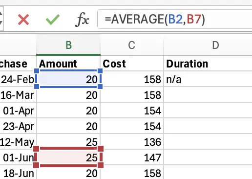

B11 strikes me as a tad too high. It seems to imply that you only averaged the last 4 purchases.
I get 21.67 for the last 6 weeks.
C11 also seems odd, as it appears you've averaged all 7 weeks. I think as before, this should only be the average for the last 6 weeks, where I get $151.17
I also get slightly different solutions in my C13 & C15, though nothing close to your $280.26
Yes, this is what I assume is happening; I just haven't figured out which ones.
Yeah, i think you're right.
This is what I thought i was doing, taking only six weeks. I checked my formulae but I'll check again.

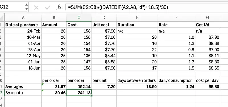

C12 should be something line sum(C2:C8)/(D11+DATEDIF(A2:A8))/30)
Adding D11 to the DATEDIF (before converting into months)
  • Skeptical
Oops. Had a comma where there should be a colon.
That does seem to give a better number, although I'm not entirely sure of the rationale.

You should think of a single order as the order happening and then a bunch of days until the next order. So the first data point you have is you spent 158 dollars and then waited 20 days until the next order. Then you spent 158 dollars and waited 15 days until the next order. The very last data point is you spent 158 dollars on June 18th and then... How long until the next order? The formula you picked basically says 0 days since you included the cost of that order but you don't have any time included until the order that comes after.
An alternate fix would be to just not include the last cost in the numerator but use your original denominator. There are merits for each approach.
Yes, this is the best approach. During the 114 days between 24 Feb and 18 June you have ordered (and presumably comsumed) a total of 105 units at a cost of $907. You have not consumed any of the 20 units you ordered on 18 June so you should ignore these.
## \dfrac{$907}{114} \approx $7.96 ## per day or $242 per month.
You could refine these calculations by keeping a tally of how many units you have in stock to increase the accuracy of how many you consume in each interval.
